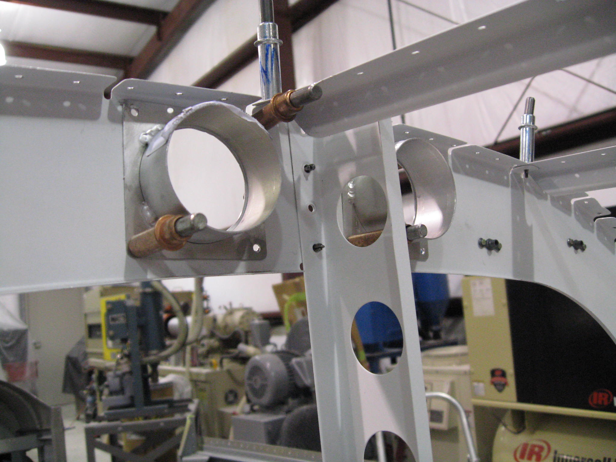

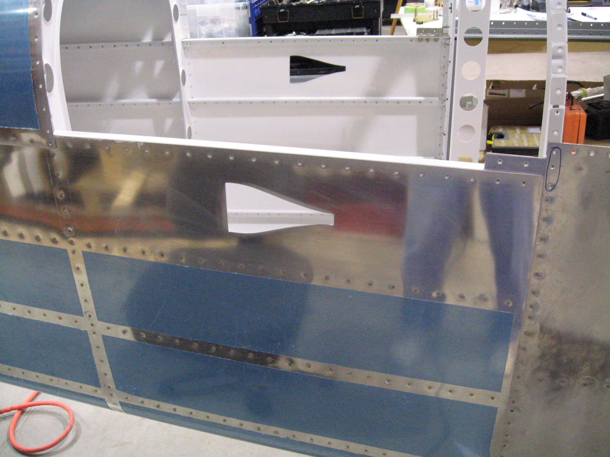

Where does the input for the airflow for vents in the upper console come
from? Are some NACA vents put somewhere in the tailcone area connected via
SCAT tubing to the rear of the overhead console through the rear baggage
area bulkhead?
Richard Bibb
571-379-3290 mobile
aerosport1
Joined: 07 Nov 2007
Posts: 231
PostPosted: Thu Aug 12, 2010 4:45 am    Post subject: Overhead Console Airflow Reply with quote

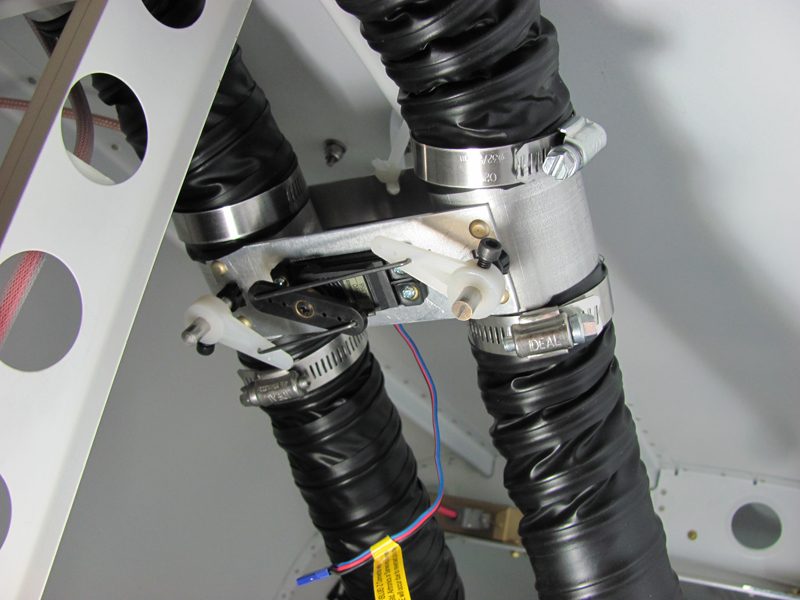

Richard here are some pictures of what a lot of people are doing. It works
really good and very easy to install. Also is a picture of my
Controller valve so I can adjust airflow as needed and totally shut of in
the winter.
Hope this helps Geoff
