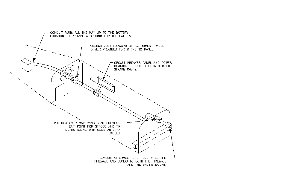

Aeroelectric Listers,
My vision for firewall penetrations includes the following: Let's envision a channel cut into the bottom of the airplane from under the firewall to as far back as needed. Sort of like the transmission and drive-shaft tunnel in an automobile.
I would put into it fuel lines, battery lines from rear-mounted battery to front-mounted starter. etc.
How does this look as far as the FAA firewall regs? What problems am I not seeing? Has this been done in other airplanes?

PostPosted: Sun Aug 08, 2010 7:22 am    Post subject: Firewall Prnetration Question Reply with quote
Eric M. Jones
Eric,
Please elaborate on how this would be done and what are the advantages.
Remember that fuel lines will come through the cockpit fuel
selector. The bus power fat wire, usually pulled from hot side of starter
relay, also needs to go to cockpit. I have a rear mounted
battery.

PostPosted: Sun Aug 08, 2010 8:23 am    Post subject: Firewall Prnetration Question Reply with quote
At 09:37 AM 8/8/2010, you wrote:
I cant speak to the regs but I personally would want some isolation
between the battery cables and the fuel lines. I'm sure you thought
of that already.
Tim Andres
Consider the ordinary shotgun shell. The POTENTIAL
for a great release of energy is designed into
the device. Yet when events necessary to set
of that release are artfully positioned and
contained, the device offers very low risk
until it's loaded for use. Then the risks
change markedly but can still be very low if
actions are considered and responsible.
Liquid lines and wiring of all types can share the
same space. What is the likelihood that a contiguous
metal line carrying liquid is going to leak simultaneously
with compromise of the insulation on a wire thus giving
rise to an extra-hazardous condition?
At the same time, you don't just stuff those items
into shared spaces without regard to craftsmanship
and common sense for support such that neither wire
nor liquid line is being abraded by vibration while
in contact with some antagonist.
Considered and responsible actions keep your
electrons and gasoline separated just as the
same actions keep folks out of your prop and
airspeeds are maintained in the window on final.
There are no specific regs I'm aware of that
speak to co-mingling of potential hazards.
Take a peek in the tail of a Beechjet and you
find all manner of electrical, liquid, controls,
accessories, batteries, etc sharing some VERY
tightly packed spaces.
At the same time there are "rules of thumb"
for support and minimum separations but those
practices are often call for separations if
less than one inch.

Sure. The first few of the Rutan pushers I was
involved with experimented with a copper tube
conduit and ground system that ran from nose mounted battery
to the fire wall.
[img]cid:7.1.0.9.0.20100809003416.02029e10(at)aeroelectric.com.0[/img]
There were a few airplanes built this way but it proved to
be a lot of work with little benefit. I took the suggestion
out of later revisions to the 'Connection.
 Filesize:  120.02 KB
