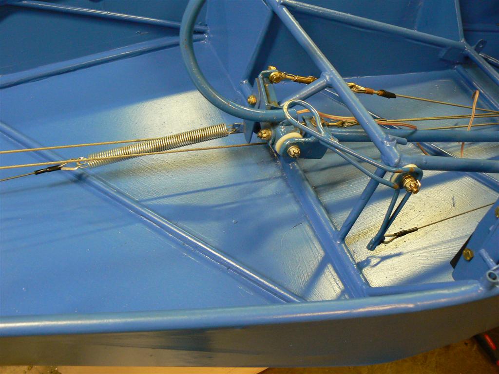

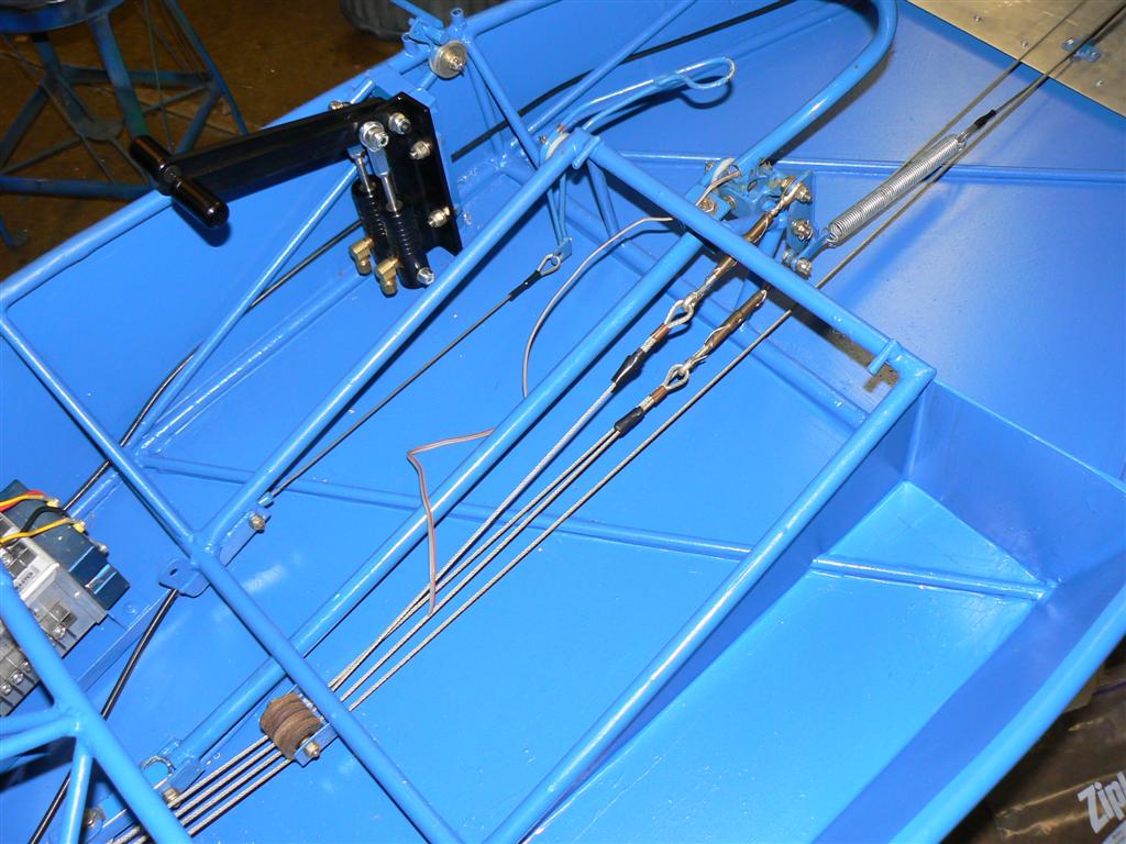

Starting to make some progress on the FSII, got the controls in today including the trim system. Here's how the trim works: welded a big flat washer to the front left side of the seat structure. Then bolt on a nylon washer and then the trim lever, made by welding some 3/16" round rod from Lowe's to a flat washer. The cable enters a standard throttle cable sheath and then loops behind the Hot Box and back to the front of the airplane, loops again and goes to the bottom of the control stick via a spring. I welded up a small attachment for the bottom of the stick for the spring to hook to.
Pulling up on the lever tensions the spring, pushing the lever down releases it. Once the airplane is somewhere close to being trimmed, this will lock it in. The pictures show the spring under tension.

Nice work Richard, when I rebuild Zulu Delta, I may have to borrow your ideas. If you prepare plans, I'll be the first in line to buy them, hint, hint. :-}

You just saw them.

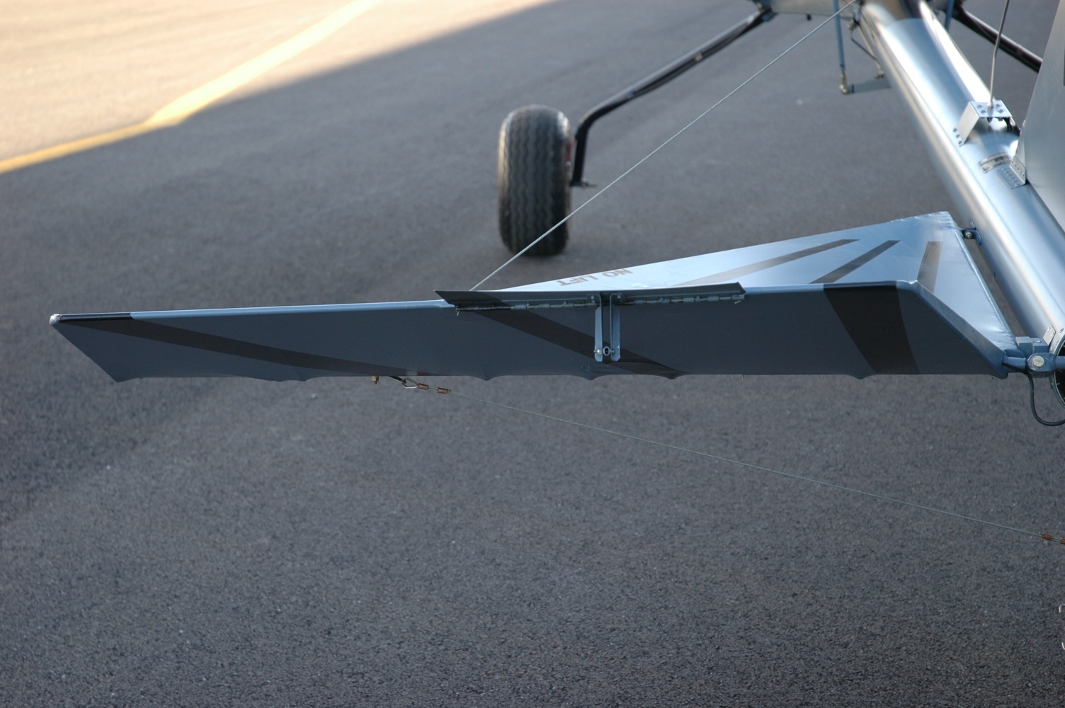

My Slingshot has a fixed aluminum elevator trim tab on the right side elevator per plans, but also has an electric in-flight adjustable trim tab on the left side elevator. I only need to change trim in-flight from neutral when in long extended climb at full power or when I want to fly very slowly with some flaperon applied. Since the elevator forces are not heavy, changing the trim is not actually required but does relieve the small amount of force on the stick.
At normal cruise, no in-flight trim required at all, though a very slight forward bias develops when my fuel tanks get low enough that I should be landing anyway. I would not bother with the additional weight and cost if I was building a FS, or SS.
As you can see in the attached photo, my in-flight adjustable trim tab is in a near perfectly neutral position which is where it stays 99% of the time.
