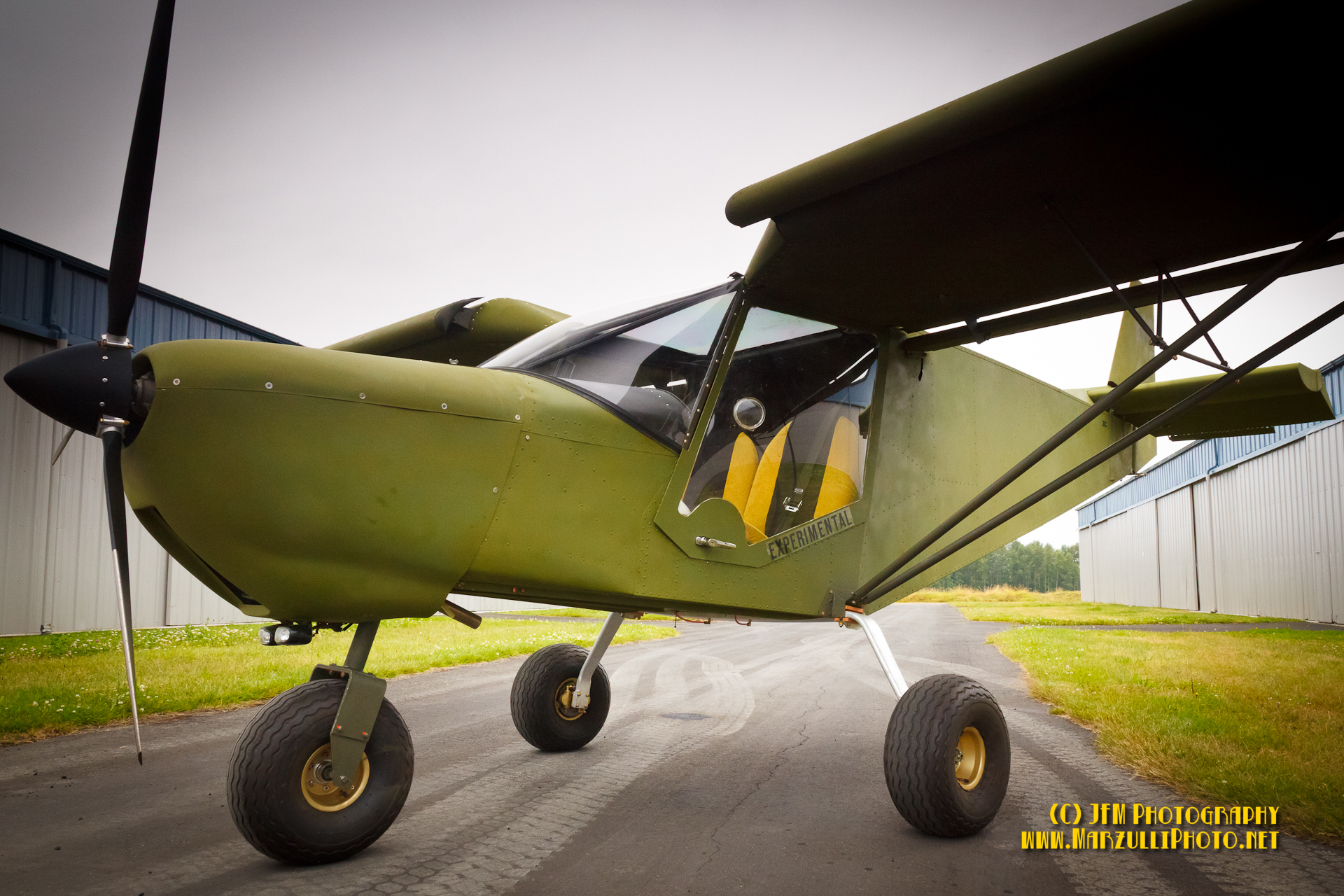

Tom was kind enough to grab a pic while I was flying. I also took a portrait of N701GV yesterday after the DAR visit.
