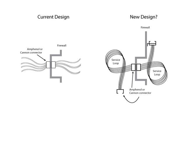

Having recently had to re-wire and reconfigure some electrical on both sides of my firewall I am convinced there is a simpler (but more expensive) way to access wires coming through the firewall.
My current configuration are a couple of Cannon or Amphenol connectors used as my firewall pass through. I assume most of us have a similar configuration. While this is not too difficult as one is building, changes after flying can be extremely difficult due to all the “aviation” crap in the way. The firewall side can be difficult but the upside down and backwards nature of under panel repairs begs for a better solution. It seems like a simple service loop on both sides of the panel would be a easy fix. The service loop of 12-18” would allow one to remotely mount the connector(s) to a position of better access. Or firewall mounting with a release bracket to give better access to the wires.
My ideal setup would be either 36-48 pre-wired jumper lengths. Maybe all one gauge wire or half one gauge, half smaller gauge wires. A couple of pass through units should be enough to solve most wiring issues.
My question is… Does this solution already exist or are people doing something else to solve this challenge that I don’t know about?
