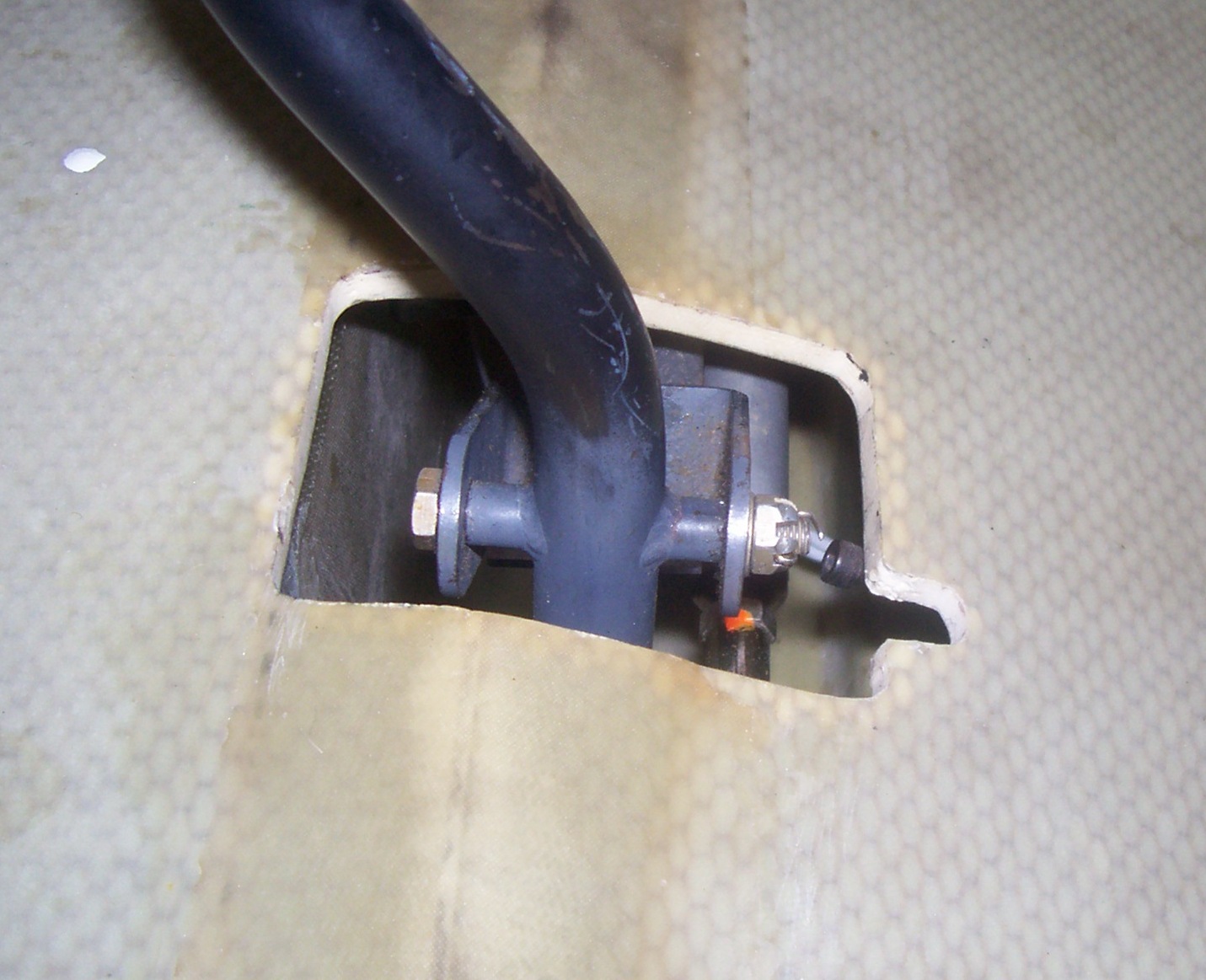

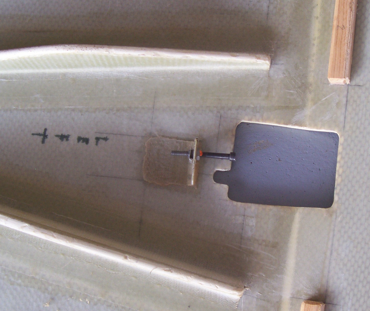

Hello Fellow KIS Builders, A follow up on pitch control stops:
1) I wrote: "Pitch: For forward stop I just let the control stick bracket
hit the
front edge of the opening in the pilot's seat bottom. For aft stop I
installed a mounting bracket and a long hex socket head cap screw (that
could be adjusted) in the aft side of the bottom of the seat bottom opening.
The control stick bracket would hit the cap screw head to stop aft
movement."
Attached are two pictures of this arrangement.
