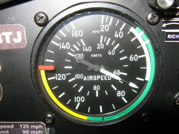

Yesterday I entered the pattern to land behind a student in a retractable doing stop and gos. They usually sit on the runway a while, and talk about it I guess.
Anyhow, I figured no big deal I'll just pull the speed back to about 40 mph and hang on down wind while they decide to take off. I glanced at the ASI when the kitfox started to feel like about 45 mph but it said 73. It didn't sink in to me that the ASI needle was stuck so I kept slowing down until I felt the stall buffet.
This time I was glad those guys were in front of me. I had time to sort out the stuck ASI. I don't pay much attention to it until I turn final then slow to 50 mph. I might have tried to slow it down more and cause a stall on final.
Here's a picture. It took me a while to see the problem. How long do you have to stare at it to see it?
Yikes! I don't think I've ever seen something like that happen.

Bingo! Took me a few seconds to see it...guess that's why you
sometimes see a little bit of shiny stuff running across those
screws, as in a clear sealer or CA glue to prevent back-out.

My first thought was a bug in the pitot. I had tapped the gage with no movement at all on the needle, not even a slight jiggle, so after I landed I asked a couple guys...one an A&P...what it might be and they both said "Bug in the pitot".
