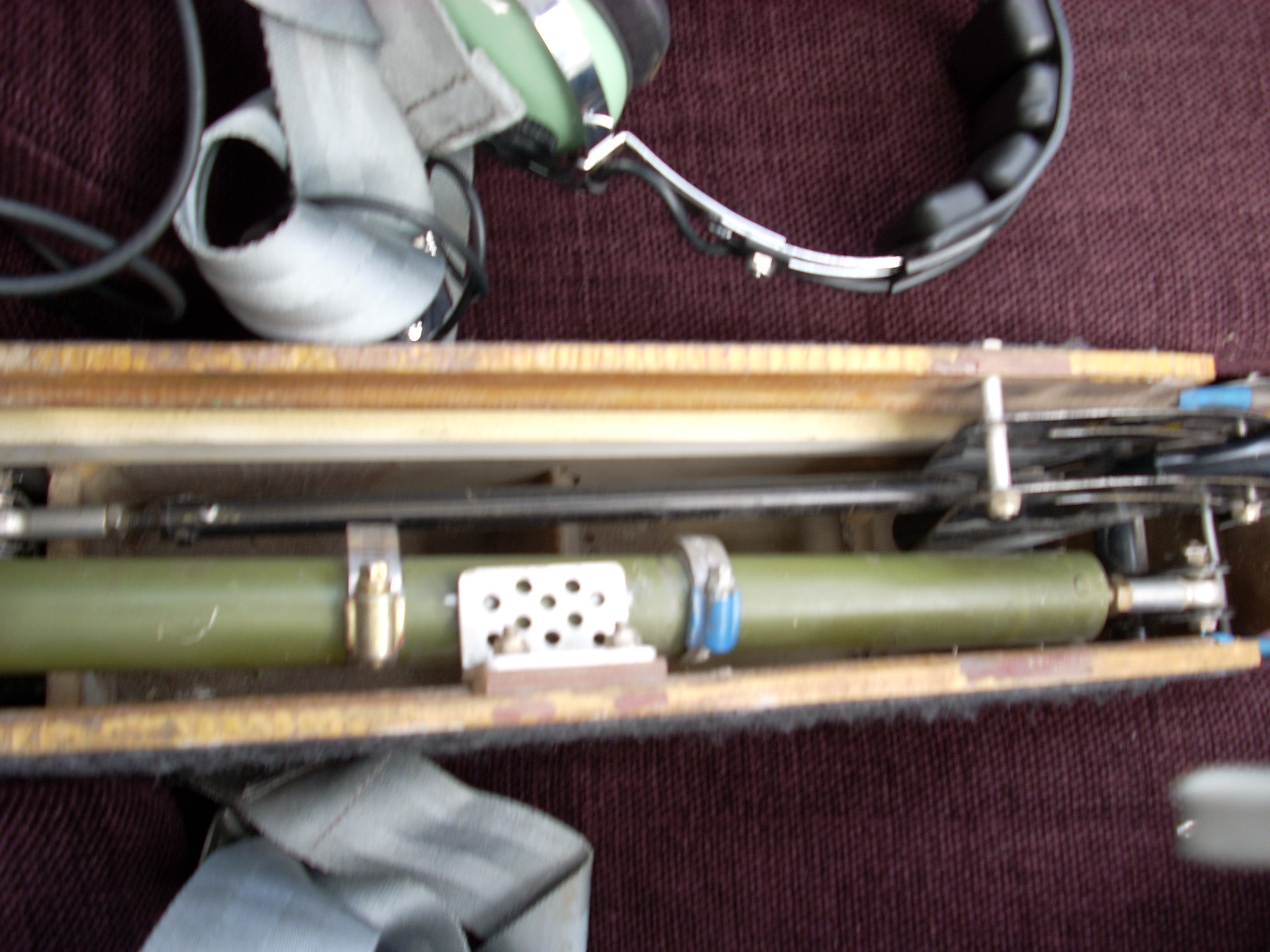

PostPosted: Thu Aug 05, 2010 6:07 am    Post subject: Control stop summary? Reply with quote
Ted
my simple pitch control stop is illustrated in this picture.
Aluminium "L" Bracket attached to side of the console tunnel and two fully
repositionable hose clamps on the main elevator control rod . ( i think i
copied this from Ray Clegg)
(See attached file: DSCN0760.JPG)
for the ailerons the sticks come with a bracket for this specific function
(or at last mine did) , so no need to invent something
