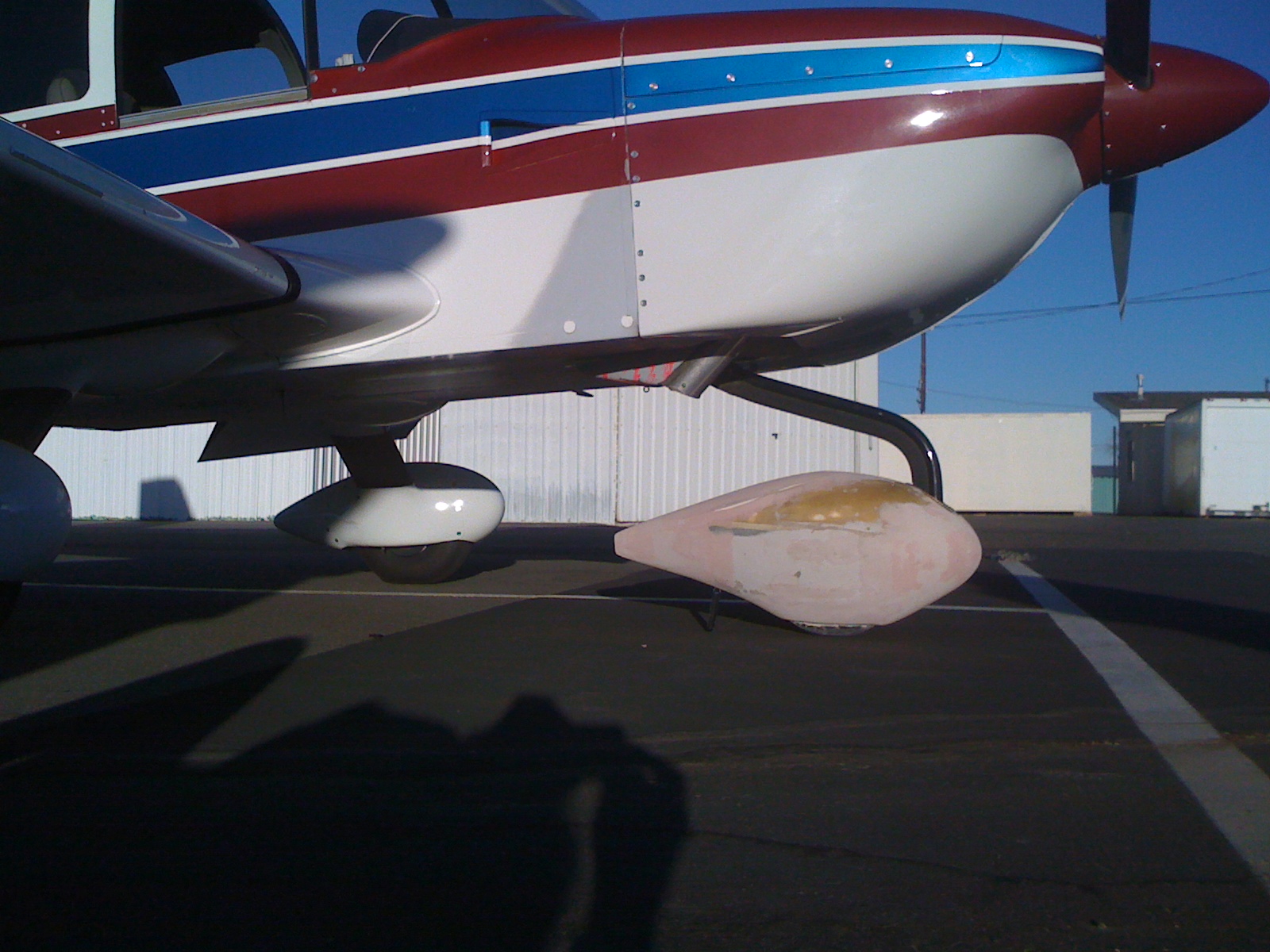

Five or six years ago, a friend of mine who was anxious to go fast, moved the sumps on his 74 Traveler, installed wheel pants and all of the Cheetah/Tiger fairings. I think (Bobby, correct me if I'm wrong) he gained about 5 knots. Over the next few months, we removed the big ELT antenna from the vertical (filled the holes smooth), buried an antenna in the dorsal fin, and installed a flush rudder cap. When all was said and done, we'd gained about 10-12 knots.
The reason I don't post any promised speed increases is because it's too easy for someone to say, "BULLSHIT." Besides, I'd have to change the POH and that's a real pain.

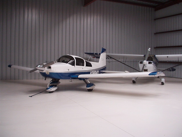

I flew 28840 this last weekend. It's pretty dirty as far as antennas and junk hanging off the plane. Straight and level at 2500 feet and 2730 rpm on a digital tach, it trued at 142. 28840 is the first plane I restored from nose to tail.

yes, sorry, talking about two different planes
