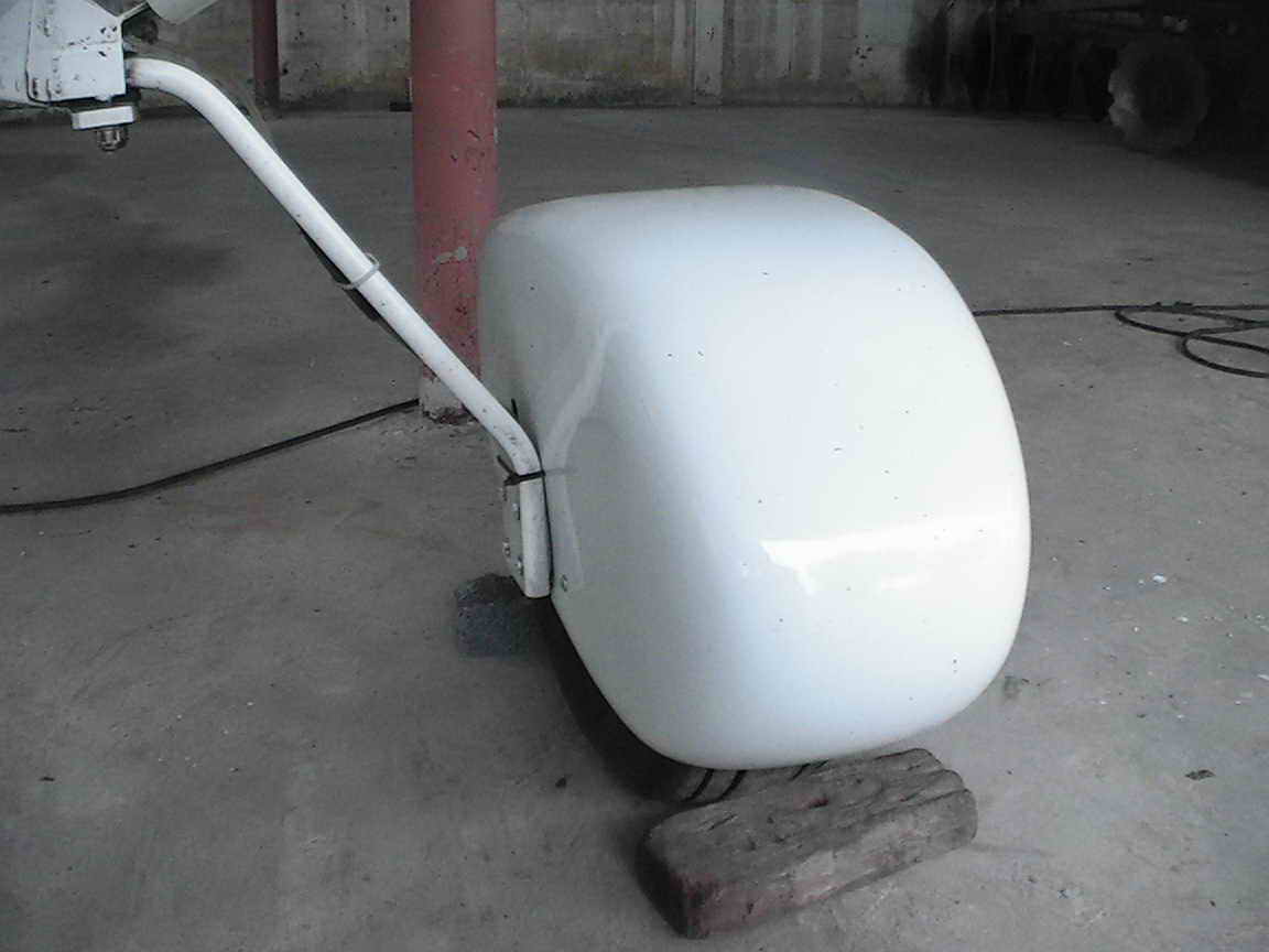

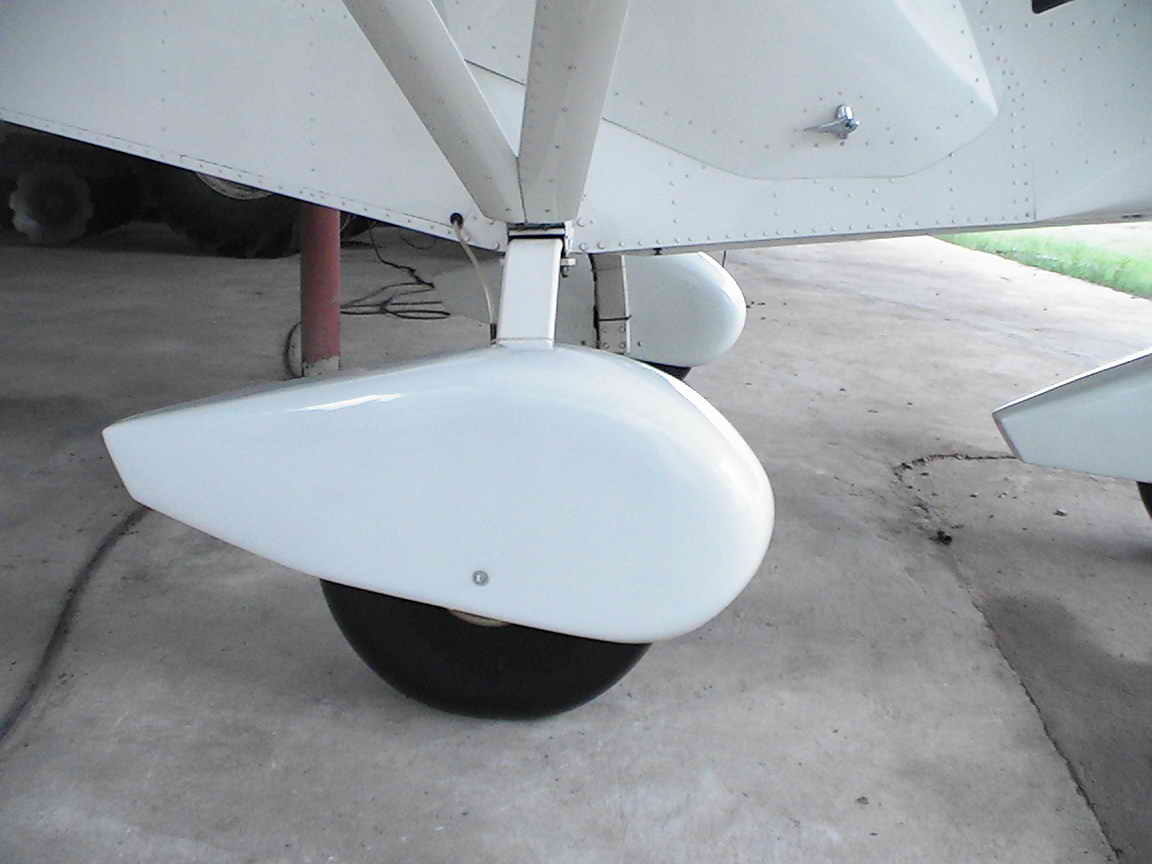

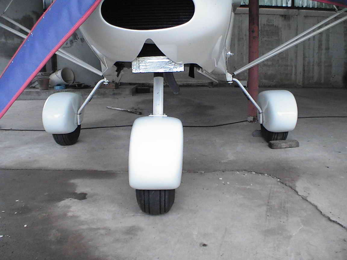

PostPosted: Sun Jul 18, 2010 3:09 pm    Post subject: Re: wheel pants for 701 - horses for courses Reply with quote
Pics here - the front fairing rides a little higher than we would like, but they do a good job.
 Filesize:  47.48 KB
 Viewed:  5461 Time(s)
 Filesize:  64.1 KB
 Filesize:  48.03 KB
