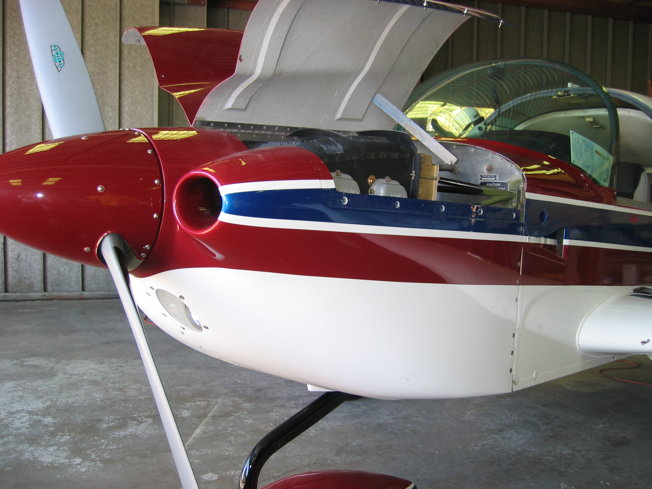

PostPosted: Mon Jul 19, 2010 5:23 pm    Post subject: TeamGrumman-List:LoPresti Nose Bowl Performance Reply with quote
pic

PostPosted: Mon Jul 19, 2010 5:40 pm    Post subject: TeamGrumman-List:LoPresti Nose Bowl Performance Reply with quote
The Jaguar cowling was approved a year ago. There are 4 out there flying, including mine. Average speed increase is 5-6 knots.
