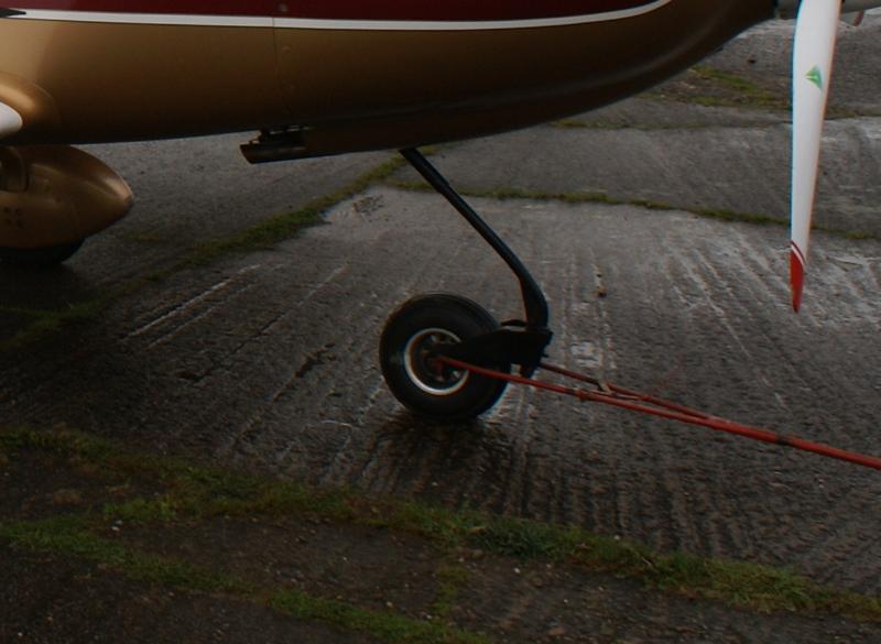

I may be confusing things somewhat. I have always assumed that my nose leg was a solid bar but to be honest, I've never checked. Certainly the threaded portion that the castor assembly is attached to seems solid.
I'll try and attach a picture to clear up the confusion. (The fillet welded onto the lower bend is a later modification).
JJ

Thanks for the advice. I've just removed my nose leg for straightening and found the 'pin' that holds the stub into the tube.
Rather than straightening the original leg, I'm considering replacing the lower tube section by drilling out the rosette weld where it slides into the upper portion.
Any thoughts about wall thickness of the replacement lower tube?  Would replacing like-for-like be the best bet or does anyone think a thicker walled tube would be stronger yet still flexible enough to take out the shock loads? Also, how about bolting the nose leg assembly back together (with suitable bushing) rather than rosette welding; this would make it easier to replace the lower portion in the future if it bends again? I'd plan to have 3 new lower sections made locally and get the whole lot, including the original mounting bracket, heat treated as per Lyles description.
Having completed 320 hours and about 750 landings (250 of which were on to grass), I'm happy that the nose leg assembly I've got is doing a good job, it's just not 'man enough' for rough fields. In future I'll stick to smooth grass strips but have some spares incase I hit an unexpected bump.

Rich and all
JJ

If I recall right the downtube (Lower portion of nosegear) is .156 wall 4130 that is bent to shape with a threaded plug pinned into place. This was then heat treated as per lyles discription. If you had heated it red to straighten you would indeed normalize the material to close to its original state. (donīt know the real details on normalizing) Lyle????. this would weaken it and allow it to bend easier. you could heat treat it again or have lyle build you a new improved gear at a reasonable price
Rich

1) JJ wrote: "Does anyone know what metal the second generation (solid round bar) nose leg...."
2) Rich wrote: "There never was a solid round bar version made by Tri R...."
3) You wrote: "Anyway I'd bet my KIS that the down rod is solid 3/4" rod..."
The presumption is that JJ was asking about the angled nose landing gear strut that extends from the firewall area down to the short vertical stub when he wrote "nose leg".
Rich answered in that regard when he said that Tri R never made a "solid round bar version".
I don't think that there was any question or doubt that the short vertical stub was solid steel in all versions of the KIS TR-1 nose landing gear. Only confusion about the solidity of the angled strut portion.
