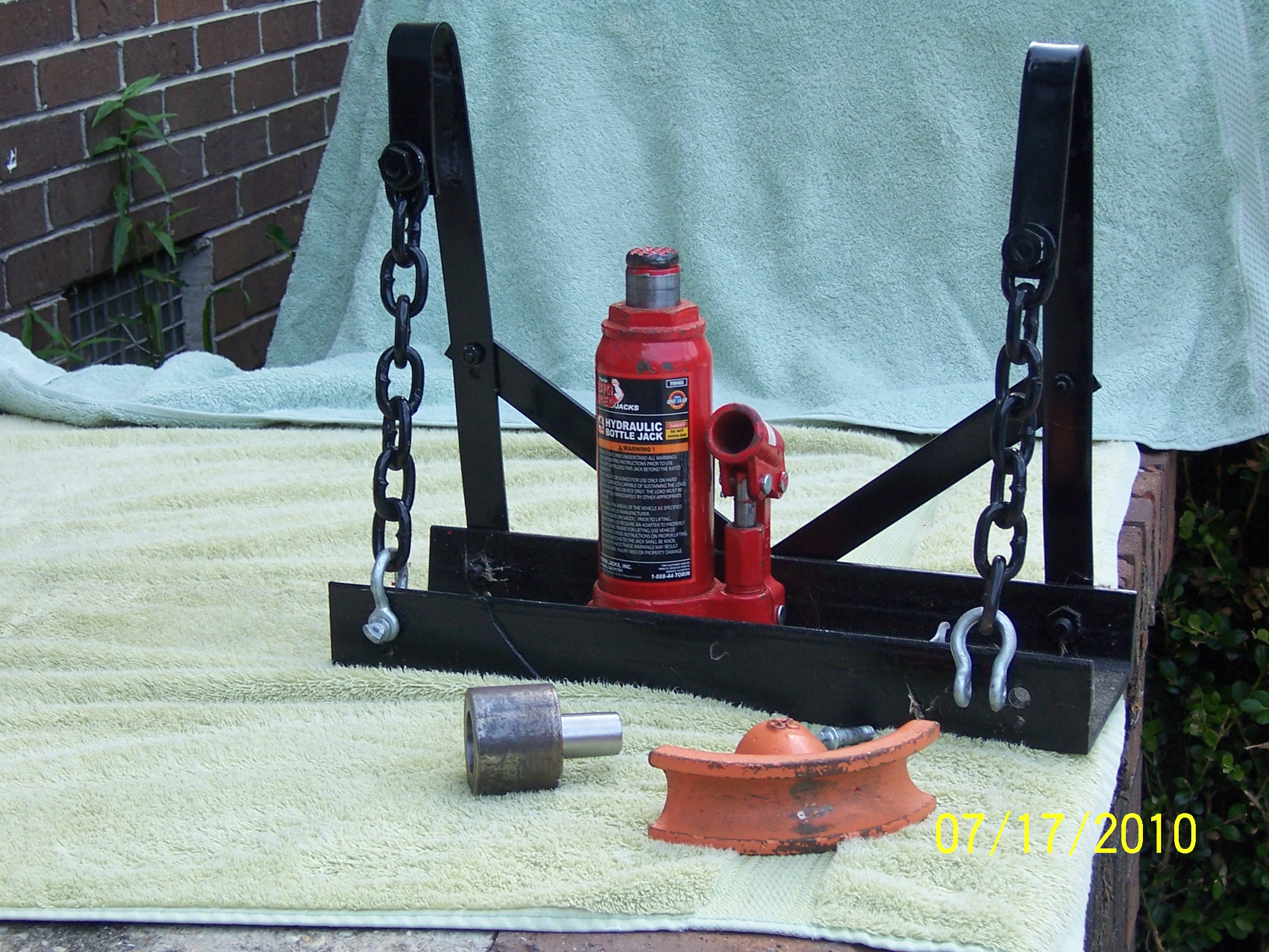

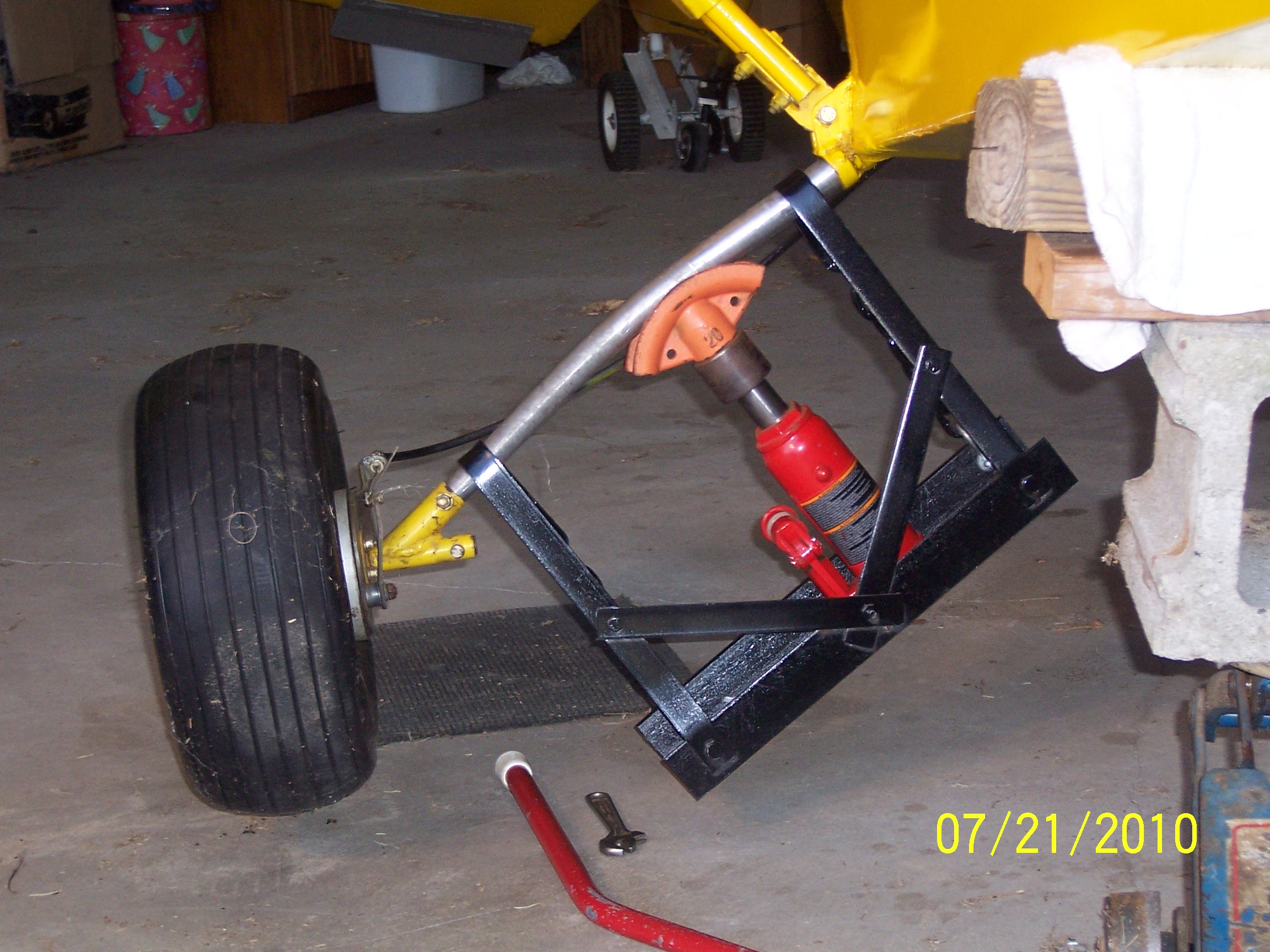

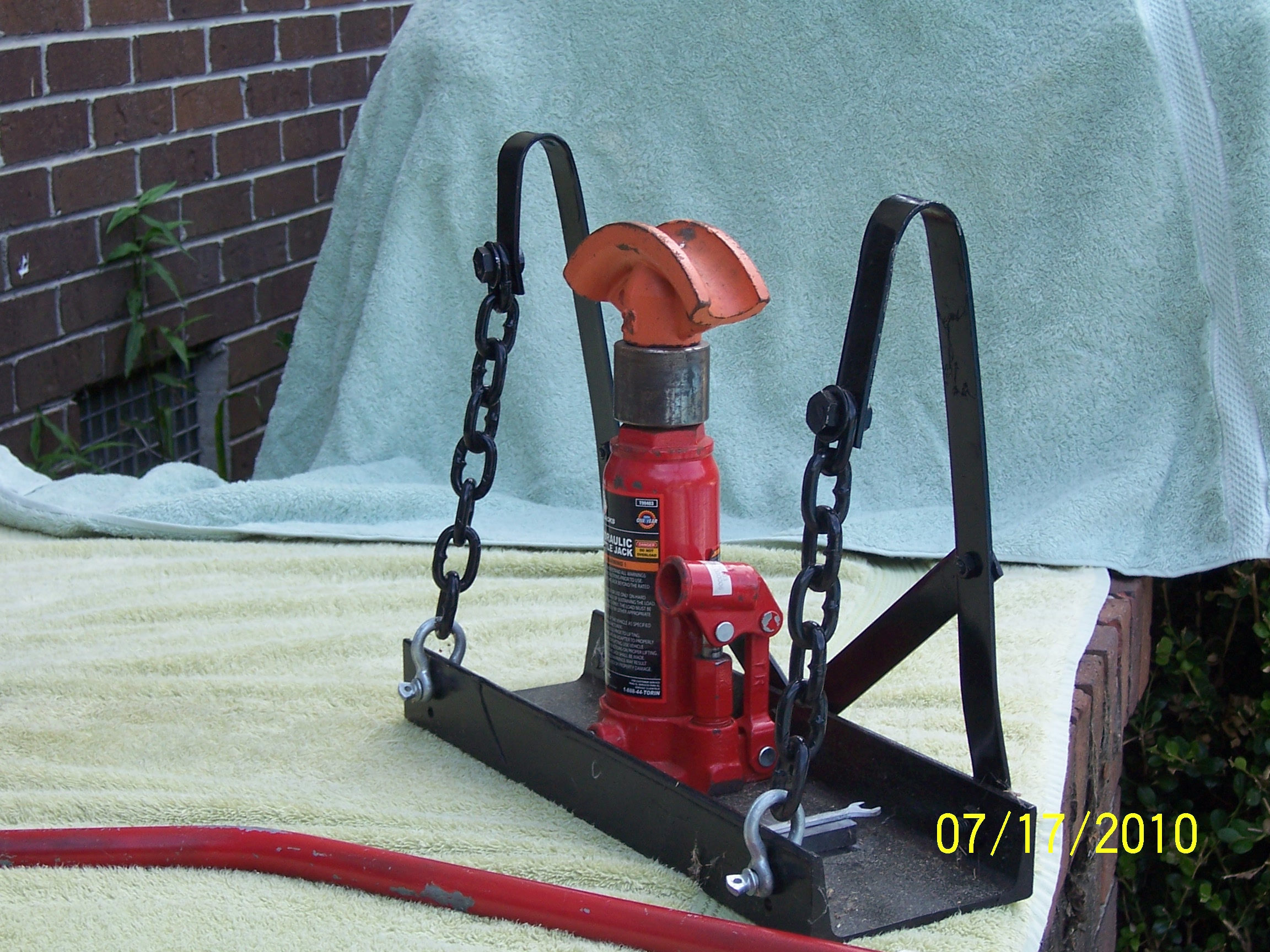

This is a portable hydraulic press that I designed to straighten the legs of my Firefly.
The unit can be used OFF the Firefly or attached to the leg without removing the wheel and associated parts.
Parts used.
5 inch wide channel iron 15 inches long
4 ton hydraulic jack, (Harbor Freight)
2 I/8 x 1 inch flat iron 17 inches long
2 1/8 x 1 inch flat iron 8 inches long (brace)
Heavy duty chain (1) 7 inches, (1) 8 inches)
2 3/8 inch Chain connectors
One jack adapter Made on lathe
One 1 inch conduit bending tool head
3/8 bolts only. ¼ inch WILL brake
1 jack handle 22 inches long to fit jack (4130), also serves as a carrying handle

Verry nice rig Jim. when you can't get to all the parts for Jims rig. just a 1/4 in. chain
with 2 chain hooks and a small hyd jack will get you back in the air again- use them
just like you would Jims rig. cheap efective and the parts can be bought almost anywhere.
