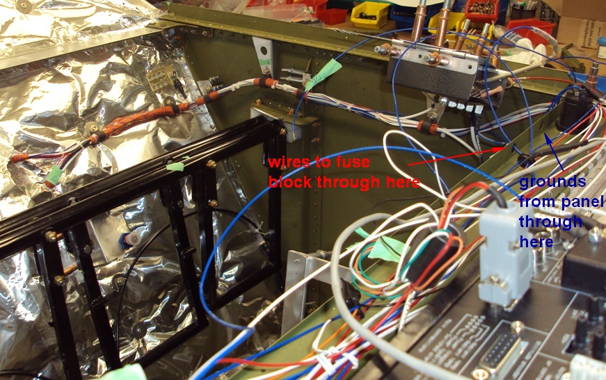

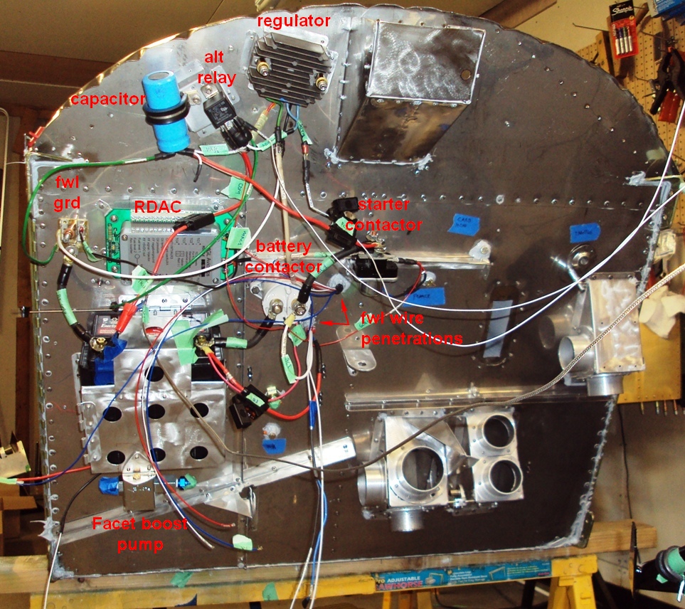

I'm finishing up my electrical wiring and am wondering about noise. I'm not sure what types there are, nor do I know all the sources. I have heard the alternator and the transmitting radio can cause problems. Also heard that anything with a pulsing signal could also be a source.
I have a 3 or 4 100-150 Mhz ferrite RF suppressors from MGL http://www.mglavionics.com/EMI_suppressor_for_VHF_frequencies.pdf. It sounds like MGL recommends putting them on any output from the radio, but not the antenna.
I've heard that twisting the feeder line to the noise maker with it's ground coming back from the device (or having the wires next to each other) will help cancel out EMF generated noise.
My schematic is posted in another thread: http://www.matronics.com/forums/viewtopic.php?t=72713. The two alternator leads are about 1' long and are wrapped together until one separates to go to the regulator and the other to the alt disconnect relay, which is right next to the regulator. The regulator output wire goes ~6" to a 10k micro (10 mili?) F 50V filter capacitor.
I forgot to label the left and right mag wires, which are dangling out the bottom center of the pic. The engine instruments will be 6 cht's, 6 egt's, fuel pressure sender, fuel flow sensor, OT, OP, carb temp, and tach. All these will plug into the RDAC above the battery. A shielded data cable goes from there back to the EFIS.
All the wires go through the firewall in either of two firewall penetations, then join together going to the right side, then back to the instrument panel and into a wire wrap along a light channel 'tray' along the bottom of the instrument panel. The pic shows the panel rotated 90 degrees in the open position.
Most of the wires hanging loose are grounds. They'll be bundled together in the final installation, and if needed, close to the panel feed wires already wrapped. Besides the mag wires (which are shielded), the only wire with pusling would be the boost pump. The radio (which may be a handheld) and strobe/nav/pos lights are not in. I know strobes are notorious noise makers. I have the shielded cable installed already in the wings.
How does this look to you? Thanks again for taking your time helping me Smile

At 11:20 PM 7/16/2010, you wrote:
Hi!
be a source.
<snip>
Suppliers of product to the TC aircraft world
are encouraged if not commanded to worship
at that altars of the gods of blissful
system integration. Catechisms for these
orders are documented in RTCA DO-160,
Mil-Std-810, Mil-Std-704 just to name the
most prevalent.
By the time the system integrator is tasked
with finding a place to bolt it in and wire
it up to make it work, 99.99% of concerns
for unhappy experience are already addressed.
Even when the hardware has not been admitted
to the social A-List for the aviation community,
the risks for noise issues are relatively low.
A single point ground for all the instrument
panel mounted goodies and paying attention
to the manufacturer's installation instructions
goes a long way to crafting a noise free future.
Ferrite beads are found useful only when the
original designer of a potential noise
antagonist/victim didn't do their homework.
To assume that they would be useful before you've
identified a real noise issue is probably not
a good use of time . . . Fly the airplane
first . . . the ferrites can probably
be willed to the neighbor kid as slingshot
ammo.
Dan

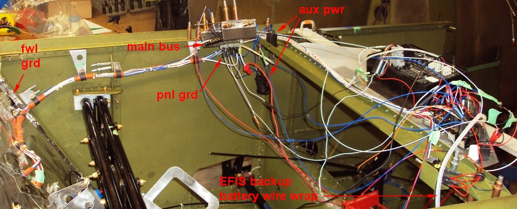

In this picture you show a "main bus" . . . what is this?
Normally, the main bus is a contiguous connection by means
of unbroken bar or strip to the power feed side of an array
of breakers or fuses. I.e., this component is already in existence
inside a fuse block . . . or is fabricated and configured
like the bus bars in this photo:
http://aeroelectric.com/Pictures/Breakers/Breaker_Panel_Busing_1.jpg
You also show a panel ground that appears to be on
the side of the fuselage. Is this a floating tie point
for the collection of all ground wires off the panel mounted
accessories? In the various z-figures, I suggest a gathering
of the grounds on what's called a "panel" or "avionics ground
bus". This is intended to offer a single point ground for a fist full
of wires and centrally located to the serviced accessories
(on the panel itself). Further, it is NOT grounded to the
panel structure . . . but serves as a handy way to extend
lots of grounds to the fire wall ground in fewer wires. For
a panel ground, you'd need something like:
http://aeroelectric.com/Pictures/Grounding/Avionics_Bus_3.jpg
and wired like:
http://www.aeroelectric.com/PPS/Adobe_Architecture_Pdfs/Z13-8Q.pdf
where I show 5 strands of 20AWG running from the panel ground
to the fire wall ground. This provides redundant, low resistance
connection (roughly 2 mOhms/Ft equal to 13AWG) between the
two busses. The 5 strands and panel ground provides a much
handier way to deal with grounds on the panel mounted
accessories.
This is a fuse block fed by a 10awg line from the battery contactor. I had incorrectly called it a 'bus'. Now I know better.
accessories?
The panel ground is made of a section of 'forest of tabs'. I took one 48 tab forest and cut it into 3 pieces. One is on the hot side of the firewall and is connected to another section on the cool side via a 5/16" SS bolt. I forget the exact numbers, but when I measured the resistance of the SS, it was only slightly higher than brass. I chose SS because of its higher melting point.
A 10awg ground goes from the inside firewall ground to another section of tab forest for the panel ground. The panel ground is on the outside (lower side) of the cover to the main fuse block a few inches from the side of the fuselage. The cover will be piano hinged to the underside of the glareshield. In the pics, the glareshield is removed, so I've used a bent piece of metal to put the blocks in about the same position.
Next step is to wrap all the wires together in a spiral wrap starting from where teh bundle enters the tray on the right side of the fuselage. Feeders and grounds will branch off where shown.

I had missed that point. I have a single 10awg wire going from my panel ground to the firewall, not 5 smaller ones. I used 10awg for my main feeder, so chose the same size for the ground.

Thanks Bob! That makes sense especially when using the D sub.
In my case the fuse blocks will probably be under the Right seat, about a
30" run up to the avionics and various switches. I'm looking into using a
swing down panel to hold the fuse blocks under the panel, but it looks
complicated. There will be 5 breakers in the panel as well. The ground bus
will be in front of the panel in an undetermined location but close to the
avionics stack.
I'm still working on the drawing and will post it soon.
For reference I am building an all electric COZY.
Okay, where are your panel equipment power distribution
busses located? How about doing a sketch on where the
power and ground busses are located along with a list
of loads on each bus.

Since you're not using a d-sub avionics ground, leave
the 10AWG in place.
Goodie!
Another person told me they'd expect noise if the P-leads are in the same bundle to the panel. That's how I've got them. But I don't have any audio system hooked up yet. Those wires would cross the P-leads or at a right angle.
Dan
