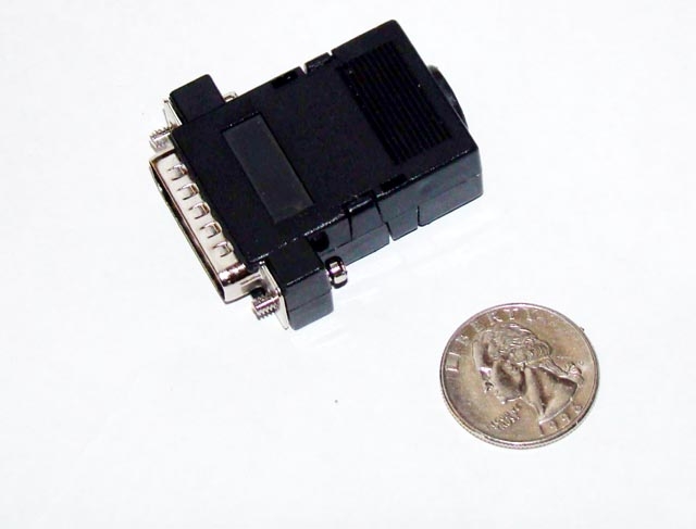

The ECB layout has been checked against the
schematic and we'll order proof-of-concept boards
tonight.
The package of choice turned out to be a 15-pin,
d-sub connector shell. The board assembly solders
right to the pins of the connector and the shell
snaps over the assembly.
[img]cid:7.1.0.9.0.20100721164915.01ecfce8(at)aeroelectric.com.0[/img]
The draft software description is done. My software
guy says he can comb it out for me over the next few
days.
Depending on parts selection and installed
software, this particular design can become perhaps
a dozen different products. First release of the 9024
will offer a quad function device. The user will select
the desired function with jumpers in the mating
connector. This allows the owner/operator to stock
one spare device for up to four different applications
on the airplane
This one will be fun to put together. It's got up to
25 components soldered to two sides of a .8" x 1.1"
board!
