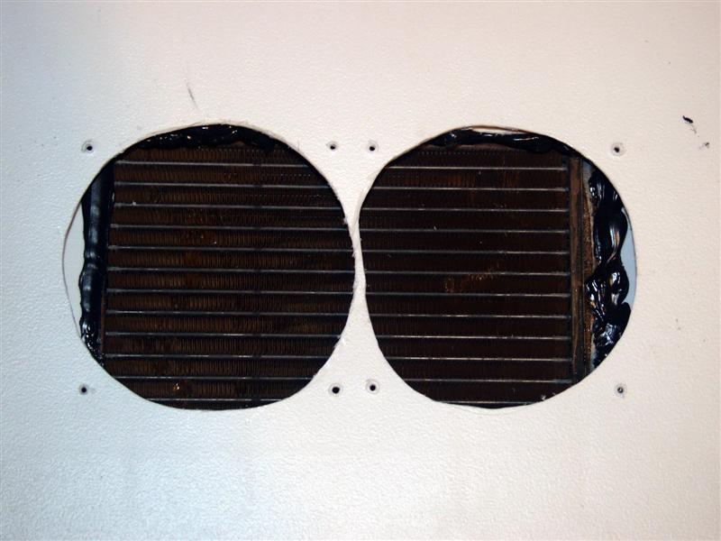

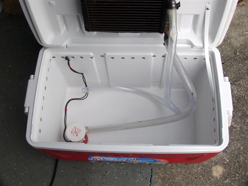

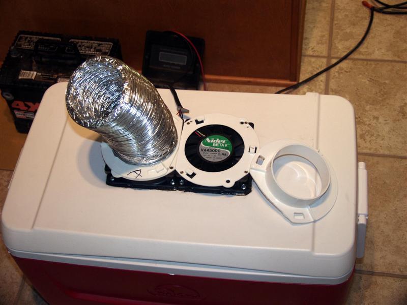

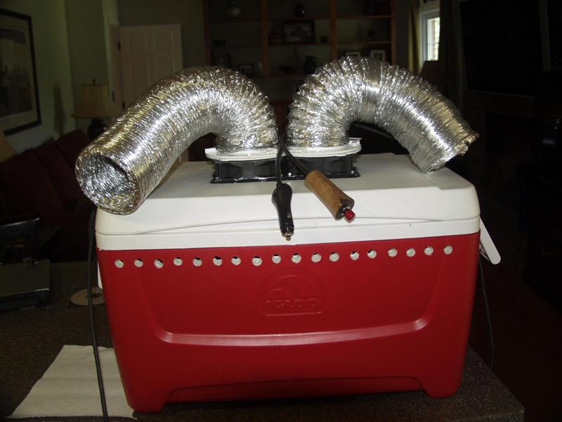

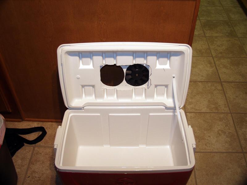

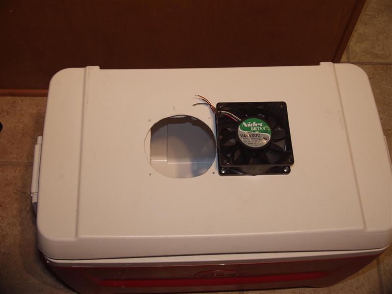

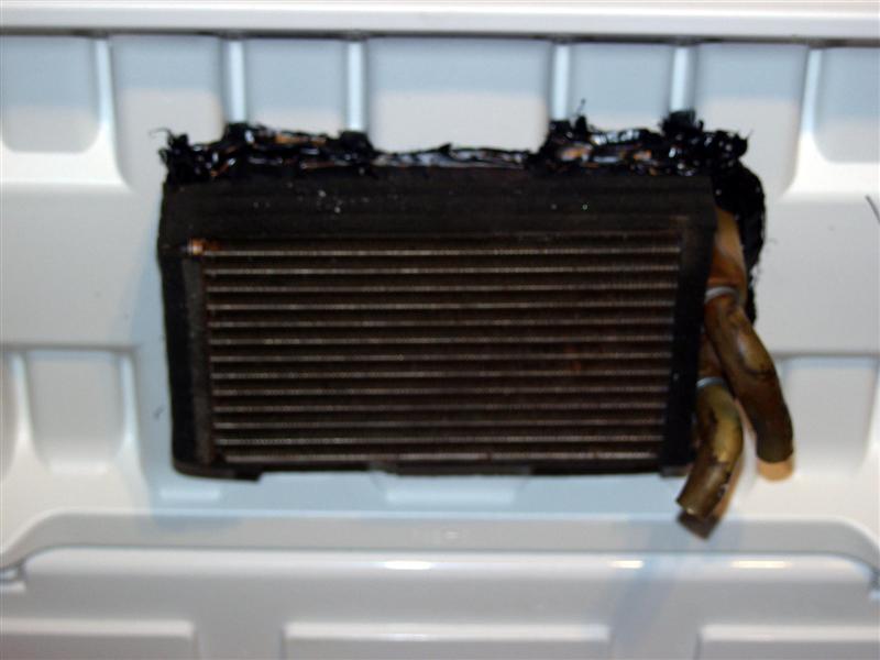

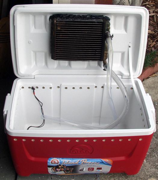

Here are some pictures of this latest project in case others want to try it. The basic idea is from http://www.instructables.com/id/Portable-12V-Air-Conditioner---Cheap-and-easy!/ (thanks again Pascal)
I started with a new Igloo cooler (48 qt. I think) from Walmart ($20) because it fits the 12" baggage door. A heater core from the junk yard (out of an Accord, I think), two new fans NIDEC VA450DC - rated at 3.3 amps, 220 CFM - server fans I think, they REALLY blow ( I have some extras I'll sell for $10 ea. if anyone is interested), a bilge pump, Atwood 500 (Walmart $17), dryer 4"X8' vent hoses, two quick connect gizmos for dryer hoses from Home Depot modified and attached to the top of the fans so that the hoses can be quickly disconnected for easy in and out of the cooler, and various polyurethane caulk, 5/8 ID vinyl tubing - Home Depot, switch from Radio Shack, wire, wire nuts, etc. Done!
It is assembled, fits in the baggage door, fans blow, pump pumps, but I'll wait until the caulk sets further to anchor the pump before I try it out with ice and water.
I went ahead and drilled 1/2" holes all around the top of the cooler so that the lid can stay closed. I like this design cuz it is not just blowing air over ice -- instead, it is actually pulling cabin air over the heat exchanger which pulls humidity out of the cabin. The on/off button thumb switch is mounted in grip I turned out of some scrap walnut I had around, and the cord is long enough to sit on the tunnel between the front seats so you can turn it on after the engine is started, then turn it off when you reach altitude and save your ice for when you're back in the heat.
Should be minimal busy work throwing a bag of ice in it. The return hose from the heat exchanger is about 5' long coiled in the chest so that you can just hang it out the door and pump the water out when you're done.
I think the amp ratings are high, cuz the male accessory plug (also from Radio Shack) has a built in 7.5 amp fuse that doesn't blow with the two 3.3a fans and the 2.5a pump. Probably would run the battery down if left running too long without the engine running. It plugs into the female socket I installed to charge the battery in the same position that Tim put his in the rear baggage bulkhead.

Good work Lew. I will probably do something similiar after our -10 is complete. It won't do much for humidity because your condensate will drip off of cold 32-40F coil right back into ice bath then reevaporate into the air but cold moist air will still feel better than hot moist air. You could seal ice/water bath chamber from cabin air then run condensate into a pan then overboard...now that would remove humidity. If you needed a little cooler evaporator temperature just add some salt or your favorite alcohol to the ice. Have fun.

Here are some numbers. It was 110 degrees in my extended cab pick up this AM. I put 2 gal of water and 2 gal of ice (from the fridge ice maker) in the cooler. After 10 minutes of running the cooler, the ice was totally melted, cabin temp was 80, exit air from the cooler was 53, water temp was 45. I think with maybe one gal of water and much more bag ice, it would last much longer. Very comfortable, and not bad for a little experiment.
It concerns me that when I pulled the plug out of the truck socket, it was more than warm to the touch. I don’t have a way to measure the amps, but the voltage on the instrument cluster didn’t vary when turning the cooler on and off (had the motor running). Maybe small truck wiring to the socket? The socket itself? The male plug has a 7.5 amp fuse built into it, and it was fine. I’ll be sure to check that heat issue when I plug it into the plane.
The air circulating over the ice/water didn’t seem to be an issue – sure felt cool and dry and the heater core was dripping condensate. But maybe later I’ll try “floating” a thin piece of styrofoam on top to help separate the water/air

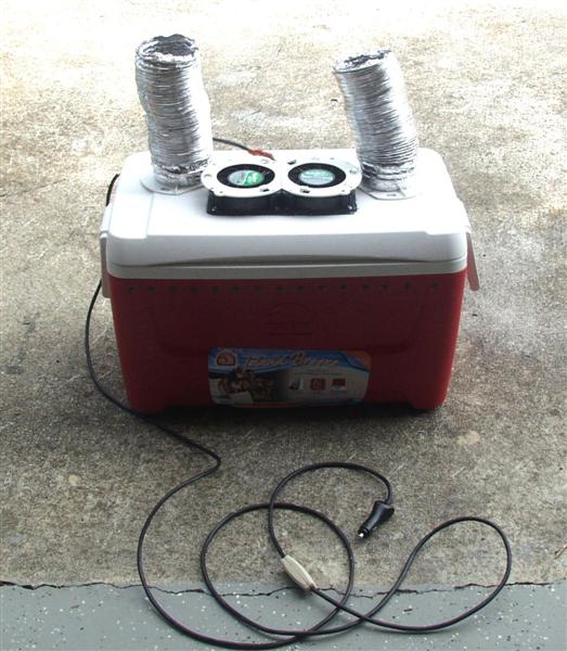

Here are a couple of pictures of the last one I made for the guy that flies a Cessna. He has his accessory outlet on the dash, so I made the in-line switch about two feet from the receptacle, with a total length of about 11 feet so that he can put the cooler in the back. The 4" ducts extend to 8 ft. and they are quick detach.
Thanks for the interest, - Lew
