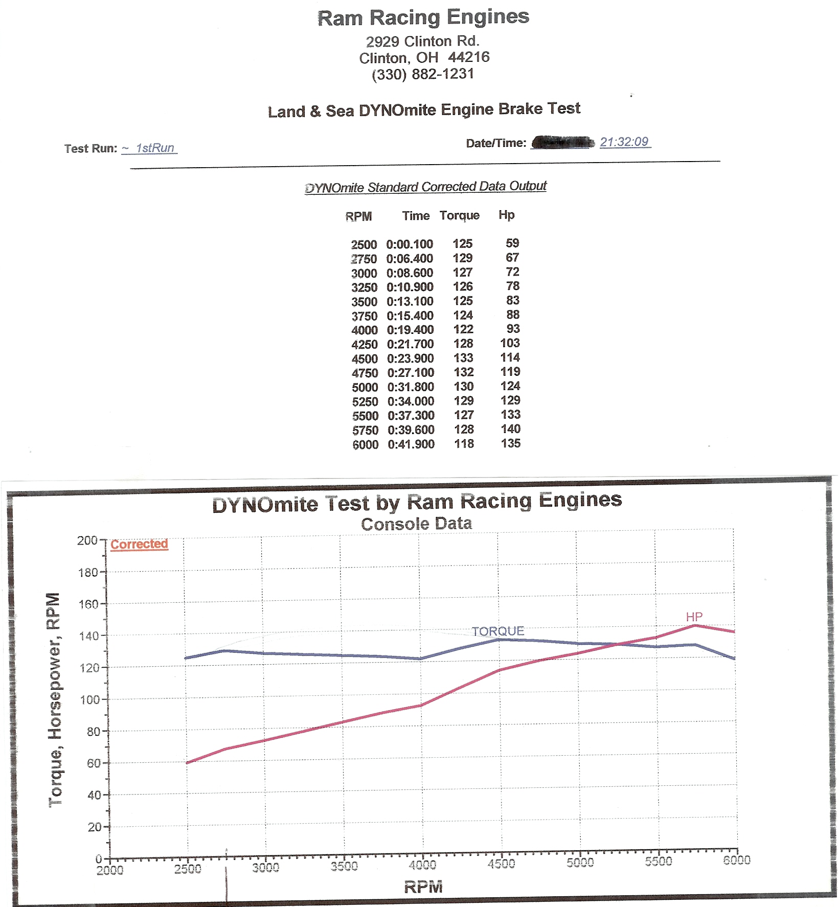

What you describe gives me pause...out of modesty, I've adhered to the manual's P factor offset rather than making a guess at increasing it in proportion to the increase in cruise power I'm anticipating. (If I cruise at 4500 rpm, engine will be putting out about 115 hp w/ about 135 ft/lb of torque...w/ my 1.9 PSRU ratio, I believe that translates to 256 ft/lb (at) the prop.). Hmmmmmm...
If you recall, was your "fix" in the nature of increasing or decreasing the offset called for in the manual?
Fred
