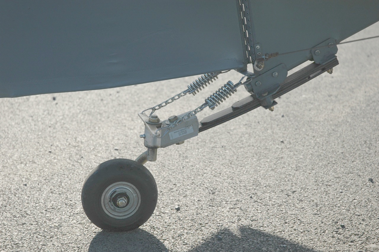

The attached photo may help see how the flat leaf spring type tail wheel mount is installed on my Slingshot. This replaced the original standard Kolb installation after it broke. The Slingshot tail is very heavy compared to most Kolbs so this extra heavy duty spring arrangement is warranted.
Leaf spring tail wheel mount on Slingshot.

Thom- How much weight is on the Slingshot tail wheel? My Firestar weighs in at 61 pounds.

Bill,
I've never weighed it but would guess by what it feels like when I have to lift it that in 3-point stance it is 100-110 lb. Current empty weight is about 530 lb. so about 20% of the total weight is on the tail in 3-point attitude.

Bill,
I just checked my W&B and noted that the current empty weight is 526 lb and in correct weighing attitude there is 105 lb on the tail.

I didn't think a Slingshot was that heavy, but considering the landing gear angle I can understand the relatively heavier weight on the tail wheel. Interesting.
