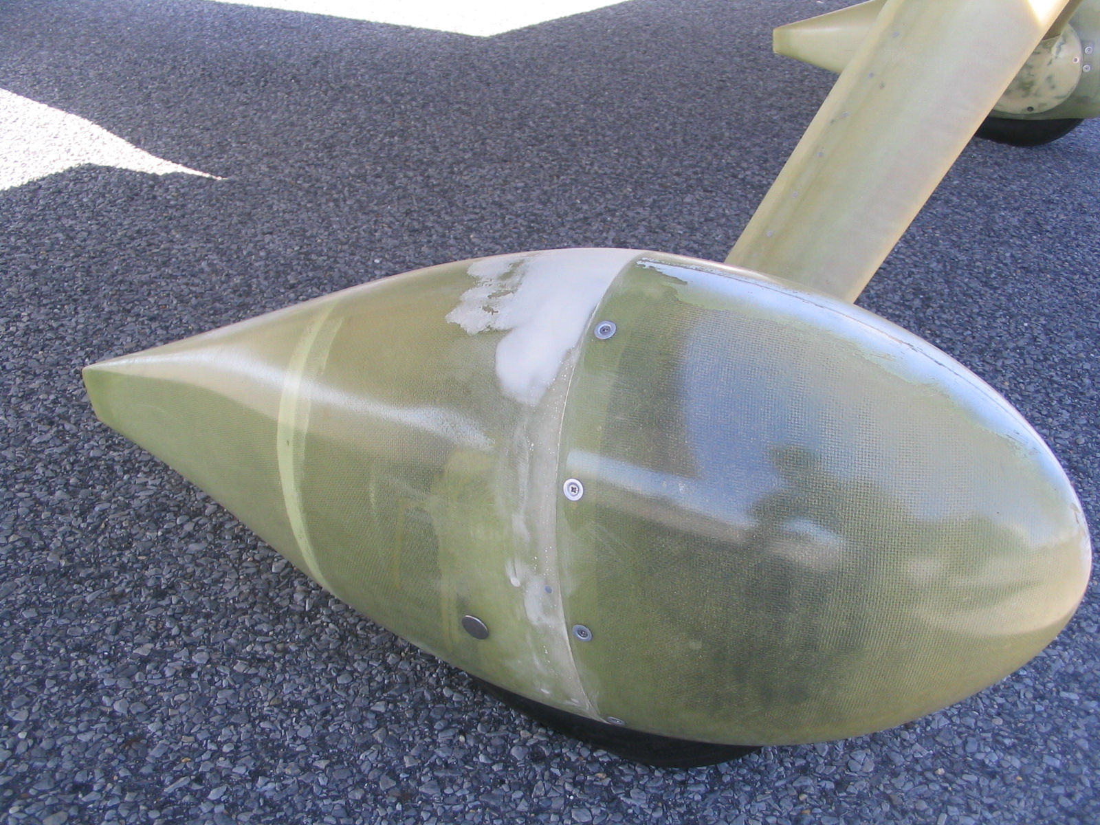

It is very easy to make your own blister.  Cover the surrounding area with clear packing tape or electric tape first, pack modeling clay or play-do over the area you want the blister and shape it with a knife, spoon or spatula, lay it over with the fiberglass and let it harden.  Peel the new blister off, clean out the clay and now glass the blister in place where it belongs.  It will take less time than waiting for something off the shelf to be found.
As for access to the valve stem, drill the hole and use a plastic or metal hole plug available at your local hardware store.

Matt,
I bought a set. Threw them in the trash. They are cheep flimsy pieces of
crap that do not fully close nor ever close the same way. Always out of
alignment. Plastic or metel plugs work much better and are very cheep.
:owes of hpme depot XA department has them.

PostPosted: Sun Jul 04, 2010 11:13 pm    Post subject: Wheelpants Part Duex - Air Access Door & Misc... Reply with quote
Matt,
Even with the stock Van's gear legs I had to make a "blister" to clear the brake caliper. I simply formed the blister on top of the wheel pants with modeling clay, glassed over the clay, the ground out the original pant material and clay with a die grinder. VoilĂ , caliper clearance.
As far as the valve stem goes, I just used Michelin airstop tubes that seem to hold air pressure very well. Your mileage may vary.

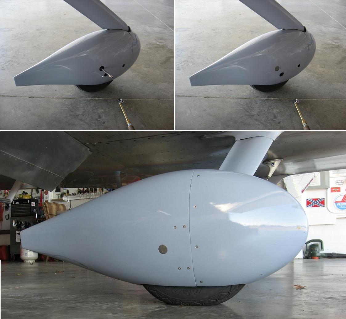

PostPosted: Mon Jul 05, 2010 3:13 am    Post subject: Wheelpants Part Duex - Air Access Door & Misc... Reply with quote
I installed and use camloc doors and they work as advertised. It is a clean installation, close tight and look professional. I purchased mine from B&B, a perennial vendor at the FlyMart for either $5 or $7.50 each. The only problem is you must find and have the tire valve lined up correctly with the opening in order to insert the valve extension but other than than, sure saves a lot of time because you don't have to remove a wheel pant just to add air to the tire. It is best to make some sort of permanent mark on the tire for that reason. I much prefer a genuine aircraft part to cheesy and common SS plugs available at hardware and big box stores best used to do what they were designed to do...plug open holes in commercial and residential electric boxes. Personal opinion, YMMV.

PostPosted: Mon Jul 05, 2010 5:27 am    Post subject: Wheelpants Part Duex - Air Access Door & Misc... Reply with quote
I did the same. Worked great.
http://blog.bowenaero.com/?p=29

Matt:
Save your money, a little weight, and time on making access to air the tires. Just remove the front half of the wheel pant. This allow you access to INSPECT the brakes every time you air the tires.
