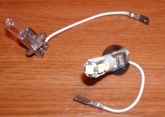

Will,
The video show quite dramatically the difference in light output. Do you know the current draw of the halogen? I'm considering replacing the broken LED landing lights on my Slingshot and the halogen sure look like a better solution if the price and current are not too high. If you could let us know your supply source too that would be very helpful.

Hi Tom,
I don't remember where I purchased the halogen light set, it could have been at an auto parts store or Walmart. JC Whitney sells a set that look just like the ones I have.
http://www.jcwhitney.com/optilux-driving-light-sets/p2003717.jcwx?skuId=151320
I don't know how much current they draw but I have to charge the battery after I land because they do suck the life out it if they are on for too long. This is why I'm trying to replace the bulbs with the LED lights
I have one more set of LED lights I need to experiment with, will post the results as soon as I have one mounted.
