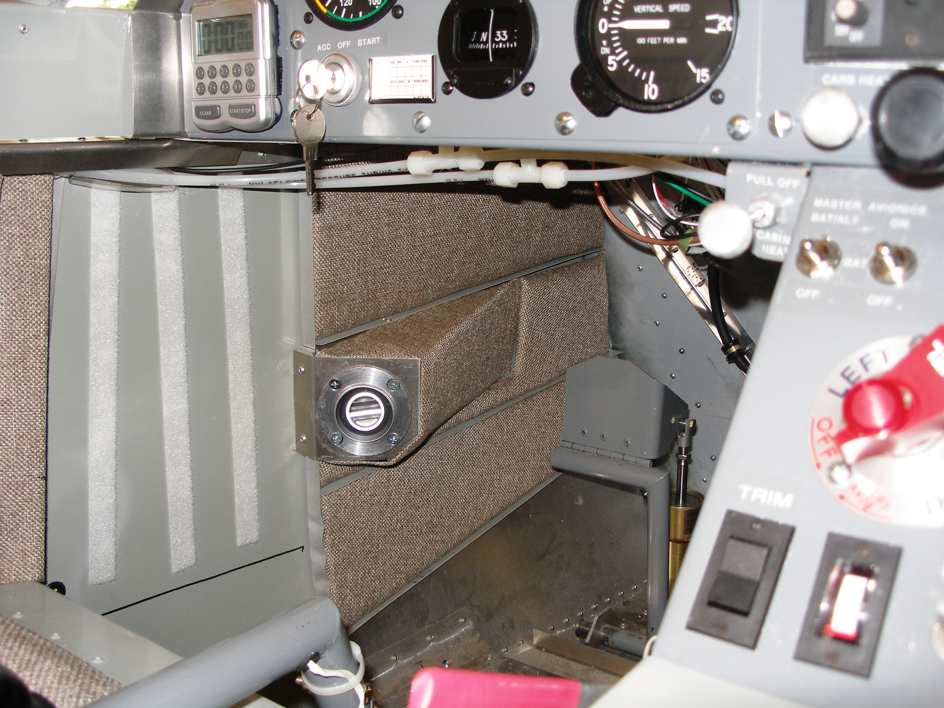

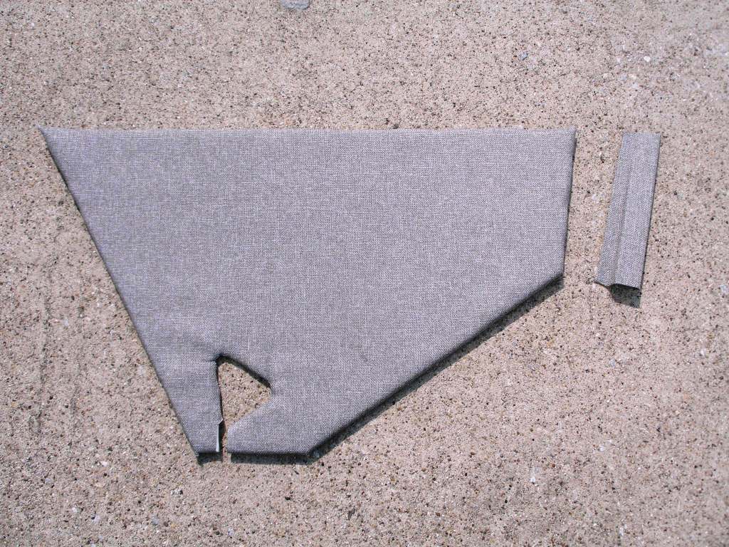

PostPosted: Sun Jul 11, 2010 3:31 pm    Post subject: seats Reply with quote
Larry,
I'm not the one you asked, but here are a couple of photos of my side wall panels. The forward panels are fastened to the skin with the upholstery level with the tops of the angles. I put vertical strips of Velcro on the skins and horizontal strips on the panels. That way, there is no blind alignment required. The panels beside the seats are mounted on top of the vertical angles. I riveted small angles to the structural angles and applied Velcro to those, again vertical with horizontal strips on the panels. All the panels were made of a plastic corrugated board as a base, with 1/4" foam and fabric applied, all from Airtex Products, Inc.
Jay Bannister
