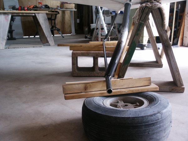

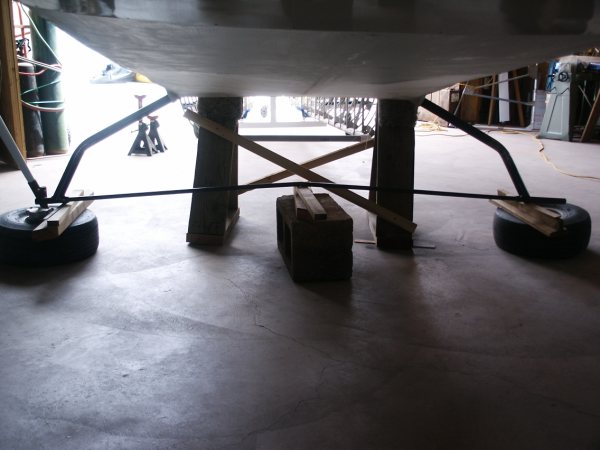

  I've attached a couple of pictures of me adjusting my axles.  I made little wooden jackstands, with cushioning on top.  There is a tube that runs between the axle sockets, and you want to catch just enough of it on each side for a secure mount......no fabric damage.
  I had some chromoly tubing left over from my frame modification.  I think it was 5/8", but I can't recall exactly, in it worked great.
  After you center the tubes (by measuring how much is slid in each axle tube), you can see whether the axles are toe-in, toe-out, or straight.
  Once you get everything lined up where you want it, drill through the upper part of the axle and the axle tube.
Mike Welch
MkIII
