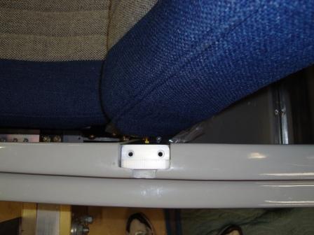

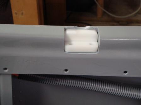

I could not see putting the clunky Van’s latch on the airplane. It is just plain ugly. I installed the 180 degree Plane Around system and recommend it with caveats and comments:
<![if !supportLists]>1. <![endif]>It works as advertised but at $470 for the retrofit kit it is overpriced. Perhaps some competition will help drive it down to a more value orientated price.
<![if !supportLists]>2. <![endif]>Be very careful not to strip out the threads in the nylon block. I did and ended up with a less than satisfactory repair by melting some of the nylon shaving you get fitting the blocks to fill then re-tap the holes.
<![if !supportLists]>3. <![endif]>I built up the bottom of the door to be flush across the door sill and had already finish painted the interior. Being very careful with a Dremmel Tool I cut a slot for the nylon catch (photos attached). The placement of the catch ended up slightly below the sill and does not interfere with getting in or out of the plane.
<![if !supportLists]>4. <![endif]>I already had the Rivet Head machined pins and pin blocks so I did not purchase the ones from Plane Around.
