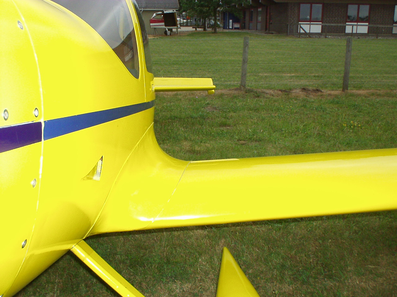

Yes, Julians was a tail dragger, and he was operating from what I would call
"STOL fields". He is now building a GlaStar, and he is not on this forum
anymore?
I have encosed a picture I took of Julians plane in 2004 at Stauning,
Denmark.
I should have taken the photo from the rear, to show the fairing from that
angle.
In my understaning, the fairing can start with a small radius at the leading
endge, and should increase the radius toward the rear. Julian had what
looked like a constant radius.
But as Mark comment - and I also agree on - is that we want some warning of
"close to stall condition". Apparently Lancair have a bad stall-crach
record, and Lancair owners I know have installed AOA system with audible
warning. ("ear-shaker" instead of stick-shaker?)
Again, regards, Hans Christian
