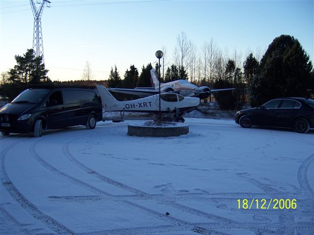

1) The highest point is a fintip + a possible strobo. When trailered, the tail wheel bottom distance to the ground is about 300 mm = 12 inches.
That means I think (imho) 6`3" is *just enough* and ok but when you pull Europa trailer into a car trailer you could lower the trailer´s front wheel even more if necessary or even take a front wheel away.

VERY good idea to use an enclosed trailer and a trailer inside anyway if you really had to tow it!
Check your Europa in every 60 miles or so!
How about you stay inside the trailer (inside the Europa!) a whole trip with continous radio or phone contact to the professional car driver?

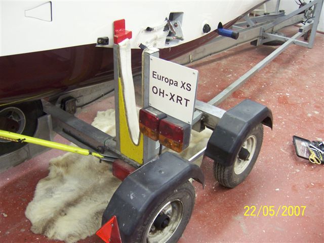

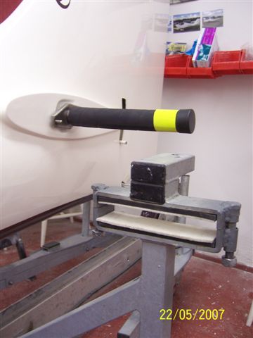

Support your Europa well (sideways) to the trailer (otherwise your main gear leg is stressed more or less)!
Notice extra side supports (a pic)!

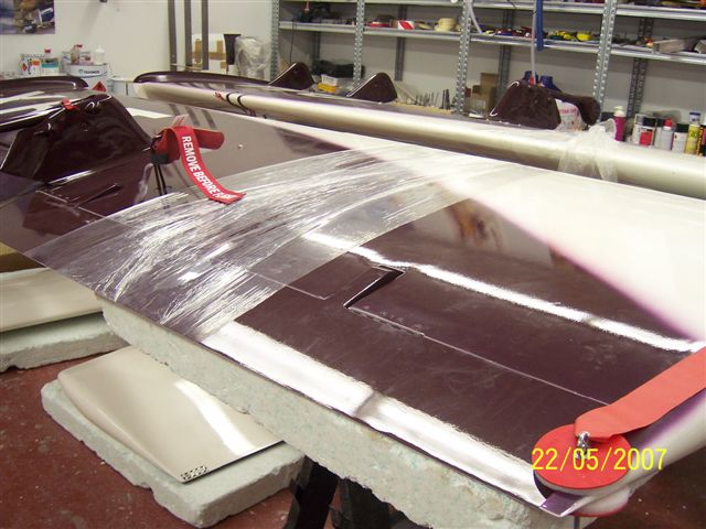

Notice to use wing safety film (a pic)!
Remember to lock the tailwheel to the trailer!
Remember to strap the Europa trailer well to the car trailer to prevent all the movings!
Do not ever never put your tailplanes to the Europa trailer - please pack them well separately (I have made a softened aluminium box like a huge suitcase for them)!

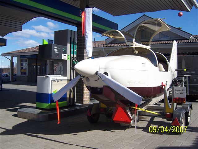

Notice the ball weight! You have to pull your trailer inside so that your prop is towards a towing car and tailwheel is behind to get a positive trailer hitch ball load - otherwise it is VERY dangerous!
When I am trailering, I use always an another car behind the trailer. So it is a two cars + a trailer formation. That is to prevent any other moving hostile object to come near or behind my trailer and to prevent possible following accidents. I know - I am almost a hysteric person - but I hate an idea to have a traffic accident with my Europa!

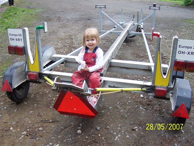

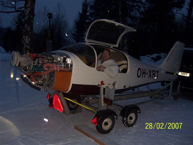

Attached a couple of my trailer pics (a floor was not installed during those days).
I hope this helps - good luck (drive carefully, again and keep the distance to the car you follow!
