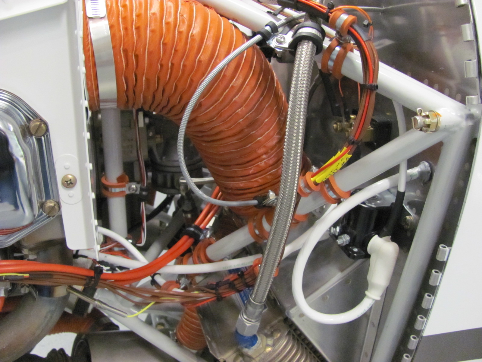

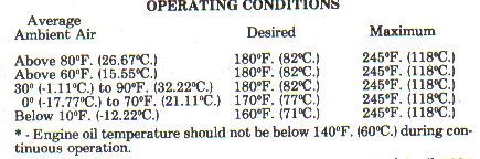

Generally accepted minimum oil temps.........160 to get moisture out of oil, 180 better. 180-190 optimal cruise temp. Keep in mind that length of flight, altitude, etc also play a role in eliminating moisture from oil. If you fly often, moisture build up is less of a concern, if you fly rarely, more of a concern. Nothing really hard and fast, more like goals. Straight from Lycoming operator's manual:

The nice part is you can leave it open and only close it in the winter when
you may want to warm things up a little. That is what I used to hate about
the winterization plates in Cherokee's. If you were a northern pilot flying
south, you would have to take off the cowl and remove the plate enroute. I
went through the formal FAA approval process to get something very similar
installed in my Cherokee 180. It's much nicer to be able to control from
a Bowden cable in the cabin. I plan on putting this on my RV-10 when it's
time.

I installed the Nonstop aviation valve and it works great. In the winter I can shut it down and regulate
Oil temps. I usually try and set it at 184-185f. In the hot summer I have it wide open and with the stock cowl and the
Larger oil cooler I see 188 to 190 on 92f days during climb. When in cruise it settles around 180-182f at altitude. It works very good. I have my valve right before the oil cooler mount I attached a photo you can see the cable but the valve is hard to see. Sorry I thought I had a better picture.
