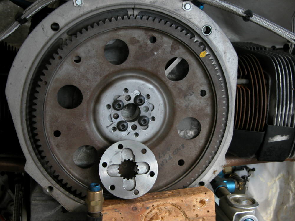

Long winded Lar in full cry. Sorry for the length of this, but it makes =
a good story, even if at my expense.
I finally found the problem causing Vamoose' oil leak, and it's turning =
out to be a bear to fix. In a nutshell, a machined piece is held onto =
the end of the crankshaft with four 8mm dowel pins, and four 3/8" =
hardened cap screws. This one goes into the engine's rear oil seal. A =
2nd piece with the splines for the output shaft bolts onto that with six =
1/4" AN bolts, and clamps the flex plate for the starter.=20
The 3/8" cap screws didn't hold torque, and were loose when I =
dis-assembled the parts. One dowel pin had broken in half. Apparently =
the six 1/4" bolts had bottomed out just as they were coming tight, and =
all had seemed well, but all 6 were broken off about 1/4" into the =
threads. Safety wire on those was fine. Getting the broken stubs out =
was....interesting. They just grinned at an easy-out. The oil seal had =
a tear in it. The engine had only run for about 5 or 10 minutes before =
it started leaking the 1st time. All subsequent runs were made without =
the prop, so's to see what was happening without getting my head knocked =
off. Torque out of that engine must be awesome. =20
Original dowel pins are .314" (8mm) dia. x .620" long. There are =
oversize pins available that are .343" x .756, and I want to use these =
for more shear strength but I've got to get the original pins out, and =
they're a press fit. OK, 3 of them I drilled and tapped and used a =
home-made slide hammer and yanked them out. No problem.....not too =
much....that a little creative language didn't take care of. The 4th =
one - the broken one - is hardened somewhat. Using the same pilot bit =
as on the others, it went about 1/4" into that broken pin before =
dulling. I have no idea what kind of bit it was. Kinda grey/shiny. I =
then used every small bit I owned trying to drill deeper into that =
thing. Not a chance. Ruined every one of them. Went to Lowe's today =
and bought 1/2 doz. assorted bits - cobalt, titanium, etc., etc. Even a =
Hitachi one that claims to "last twice as long as others." None of them =
even touched it. Now, the big question - what can I use to drill that =
pin out of there ?? If I can't tap threads into it after drilling, (and =
I'll be very careful, believe me) I'll hafta go larger and drill it out =
completely. What kind of bits will do this job ?? I know something =
can, cause that small pilot bit went in 1/4". Help ! ! !
For re-assembly - I've already thoroughly cleaned the 3/8" threads, male =
and female, and will loctite them this time. Suggestions for which =
version of loctite to use would be welcome. I've drilled and tapped 6 =
more holes in the 2nd part, for a total of twelve 1/4" AN bolts. They =
came in from A/C Spruce yesterday. I drilled .2" (2/10ths) into the =
threads so's to put the shank of the bolts in shear rather than the =
threads as had been done. Also drilled and tapped them deeper to =
eliminate any possibility of bottoming again.
I guess this has all been for the better, for all the frustration, =
because it would certainly have failed completely in a very short time =
in the air. I never thought to even check it out, because the oil was =
clearly leaking from the input shaft of the re-drive on prior runs. =
Only after installing the Speedi-Sleeve did that leak dry up and stop =
masking this 2nd one. What a raging pain in the neck........but at =
least I've got a solution in sight now - if I can get that 4th dowel pin =
out of there. Lar.=20

PostPosted: Wed Apr 26, 2006 8:05 pm    Post subject: Re: Drill Dilemma - Long Winded Story Reply with quote
Nope, the broken piece is in the crankshaft, and, thankfully, I was careful and didn't break off a drill bit. I tried heating the 1st one I pulled, but didn't notice any difference, and don't really like to heat that component. I'm not crazy about Lowe's myself, but figured brands like Bosch, DeWalt, etc., would be the same in any store. I like the welding shop idea, I'll try it tomorrow. Thanks.
Lar.

out =
male =
pin =

PostPosted: Thu Apr 27, 2006 3:22 am    Post subject: Drill Dilemma - Long Winded Story Reply with quote
Larry
If you can't use heat maybe you could try cold. Get some liquid nitrogen, it
boils at -325F degrees. Sounds dangerous but really isn't. I used to
distribute bull semen for artificial insemination of cows and we used liquid
nitrogen by the gallons. We bought it at the local welding supply where they
sell oxygen and acetylene and transported it vacuum insulated storage tanks.
For very small quantities you could use a thermos, vacuum insulated type,
preferably stainless steel, but the glass type will work for transporting.
You will have to use it right away as it will boil away in about 24 hours.
Chilling the pin may be the challenge. I removed all warts from family and
friends by dipping a drift punch in the nitrogen until it was chilled, then
holding the punch on a wart for just a few seconds until frozen. The warts
then fell of in a couple days. This process may work for you. I've used it
for other press fit applications and it worked very well. Liquid nitrogen
can be dipped with a plastic pitcher and poured but it will be boiling
continuously in the pitcher. Of course avoid contact with skin or you will
have instant frost bite. I don't recall the price, maybe $1.00 per gallon.
Another source would be your local artificial inseminator, check yellow
pages. Your local welding supply may not be interested in filling a thermos.
Good luck
Terry

PostPosted: Thu Apr 27, 2006 5:36 am    Post subject: Drill Dilemma - Long Winded Story Reply with quote
Being an ole Tool maker, many times I have used this method to remove
hardened broken dowel pins and even bolts.....use a short piece of steel
tubing, alittle less in diameter than the dowel or screw, position the
end of the tubing on the broken dowel and using a stick welder and a
small welding rod, reach through the tubing with the welding rod and
puddle weld the tube to the dowel and walah, most of the time anyway.
