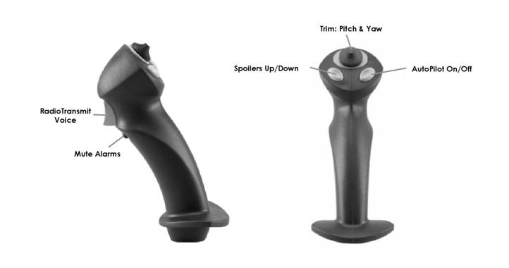

Hi Bob and everyone,
Thanks for the history of the Precise Flight Speedbrakes/Spoilers. Since they brand them “speed brakes” I’ve been using that term even though I know they are really spoilers. The accident scenario you described really brings to light how someone without a clear understanding of what they actually do could call for them at a bad time.
I think they can be easily misunderstood since even spoilers can perform as speed brakes. I like to think of them as lift/drag ratio reducers. As you point out, an aircraft designer can go after bumping up the drag side or lowering the lift side to give the pilot more aircraft control when high on energy and wanting less altitude and/or airspeed. Even as spoilers they can act like speed brakes since when deployed, lowering lift, one can increase the wing angle of attack to keep the same lift (hold same altitude rate) while getting higher drag at the new higher AOA, slowing the airplane down…
Anyway, your accident example has convinced me to label them as spoilers and not speed brakes.
The discussion has me reconsidering my decision to add the spoiler control to the joystick grips. But, let me summarize my rules for picking what’s on the stick.
<![if !supportLists]>1. <![endif]>Actions required frequently
<![if !supportLists]>2. <![endif]>Functions needed while it’s very inconvenient to remove hand from throttle
<![if !supportLists]>3. <![endif]>No functions that if accidentally activated would create a safety of flight issue
So these are my basic criteria for selecting what’s switches are on the joystick. Based on this, I’ve tentatively made these assignments:
For those who can’t see the graphic, I have:
Hat Switch: Pitch & Yaw Trim
Trigger: Radio Transmit
Lower Button: Alarm Mute
Upper Right Button: Autopilot On/Off Toggle
Upper Left Button: Spoilers Up/Down Toggle
I did not put flaps or gear on the stick since one usually only activates them twice during a typical cross country flight and if they were to be accidentally deployed when flying too fast it would damage the aircraft – violating strategy rule 3 above.
I’m thinking having the spoilers on the stick is a good option because the Lancair Legacy is a very low drag airframe making them very useful for descents, the Legacy can be easily landed with them deployed, and there is no speed limit on their deployment. With this discussion ongoing I have heard from a Legacy flyer with a spoiler switch on his throttle control and that he wishes he had a guard on it because it has been accidentally activated a few times. The good news from his experiences is that he’d even landed without realizing they were deployed and it was not an issue. I’m also checking with another Legacy flyer who has the control on his joystick to see if it’s been a problem for him or if he’d do it again. From earlier discussion with him he said he did it because the Mooney he used to fly had it that way and it was very convenient to toggle them when needed on descents.
Anyway, I appreciate and encourage the discussion about the best way to design all this with aircraft operations and human factors in mind.
Even if I don’t do it this way, I’d still like to know the best way to design a circuit to toggle back and forth between two poles with a push button switch… J Anyone have any advice on that question?
Valin

PostPosted: Sun Jun 27, 2010 10:38 am    Post subject: Push Button "Speed Brakes"? Reply with quote

PostPosted: Sun Jun 27, 2010 1:32 pm    Post subject: Push Button "Speed Brakes"? Reply with quote
Hi Valin,
  I would suggest putting them on the throttle. That is where they were on military aircraft I flew. The beauty of having them there is it is extremely easy to develop a habit pattern of activating the spoilers to retract WHENEVER you ask for full power. There are thumb switches that have existed for these production aircraft so I would think they would be available. See if you can find pictures of military aircraft like the A-4 whose throttle had that setup. As the throttle is advanced the thumb pushes the thumb switch forward to retract the spoilers and vice versa when low thrust high drag is needed. Good luck.
On Jun 28, 2010, at 2:34, "Valin & Allyson Thorn" <thorn(at)starflight.aero (thorn(at)starflight.aero)> wrote:
1. Actions required frequently
2. Functions needed while it’s very inconvenient to remove hand from throttle
3. No functions that if accidentally activated would create a safety of flight issue
<image001.jpg>
Valin
