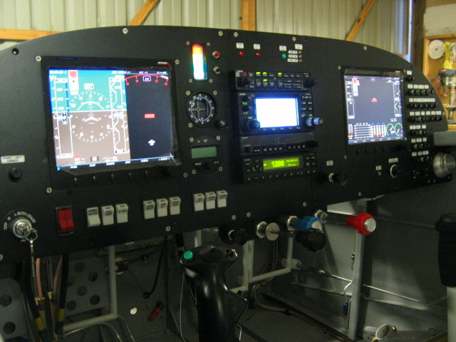

Your welcome to take a look at mine.  I'm based at 5W5 just south of Raleigh.
I've found on my panel that everything on the right 1/3 of the panel is difficult to see and use especially in flight.  My radios are fine, but the EFIS, CB's and IPOD (not shown) are a pain to read and adjust even in slight turbulence.  I pull the electronic aproach plates up on my right screen during instrument approaches, but they are not ideal since they are so far away.  Adjusting a radio at that distance would probably be equally annoying.
My suggestion for your panel is to squeeze everything together more if possible.  This would obviously require different equipment choices, but maybe just opting for smaller EFIS screens.  I've found that using the 3 view on my AFS display works really well for me and doesn't seem too small.  With two small screens you would have even more room than I do on one screen split into EFIS, Engine Mon., and Map.

Hey Greg (and everyone)
I've actually seen your panel plenty of times at EAA 1114 and at the Mid-Atlantic Fly-in, etc.
It's a great panel, but it was only after this weekend, when I actually go to sit in an RV-7(http://n999za.wordpress.com/2010/06/27/sat-in-my-first-rv-7/) that I've realized how close the panel is to the pilot. The proximity (while not necessarily a bad thing) definitely does make the angle of view to the right side of the panel pretty large (small?). Unless things are anlged toward the pilot, you are absolutely right...they won't be that usable for flight-critical information.
I am now thinking about down-sizing to some 7-inch screens, both left of the radio stack, which can now be moved closer to center, or moving the stack to the center, and putting a 10-inch screen on either side, directly in front of each seat (A great example of this layout, with the SkyViews, is on the VAF frontpage today... http://vansairforce.net/delete_eventually/9fd8g98fdg8g7.jpg) The question now is will teh engine monitoring stuff be usable on the left quarter of the copilot display, or will it need to be on the right quarter of the pilot display. (And is the moving map usable enough over there. I don't want a setup like this if I end up putting all three on the pilot's PFD all the time.)
Most importantly, the far right side of the panel does not seem like an ideal place for a backup display (as shown in my original concept). That'll have to come over to the left side of the panel somewhere.
