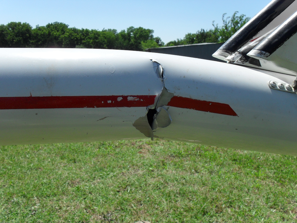

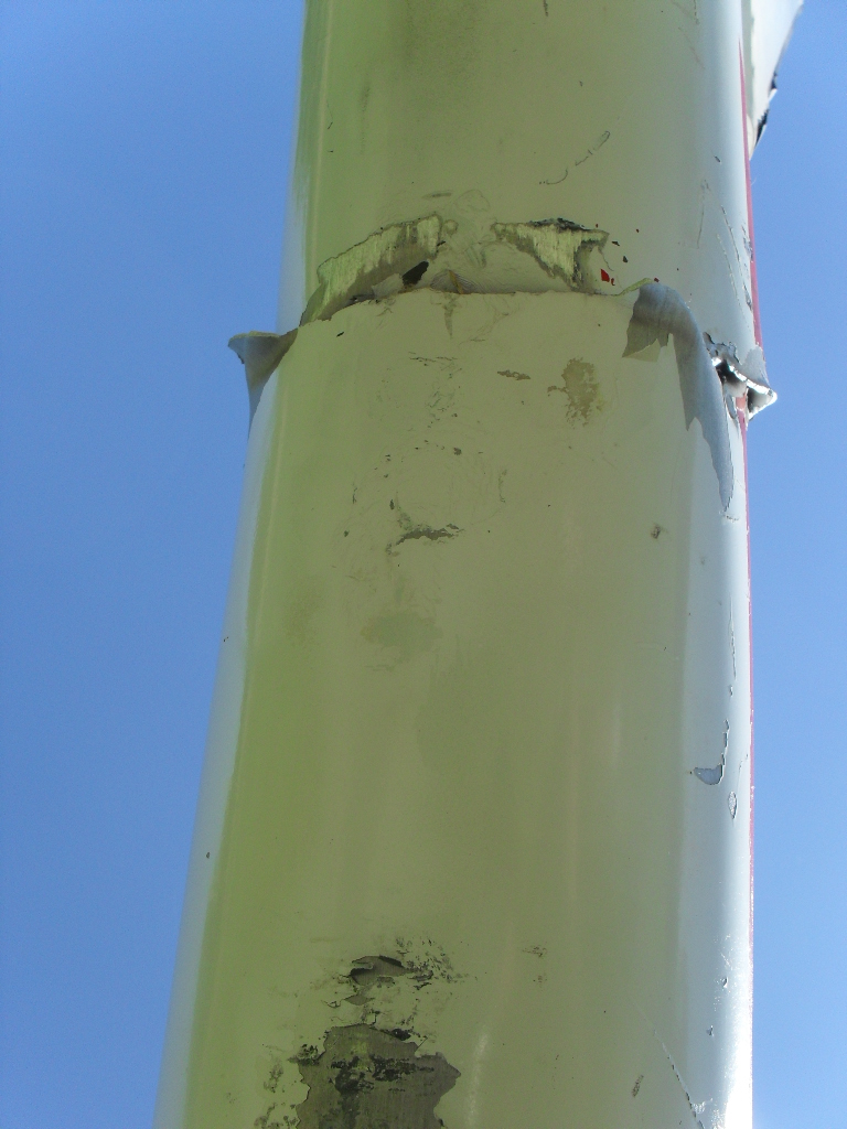

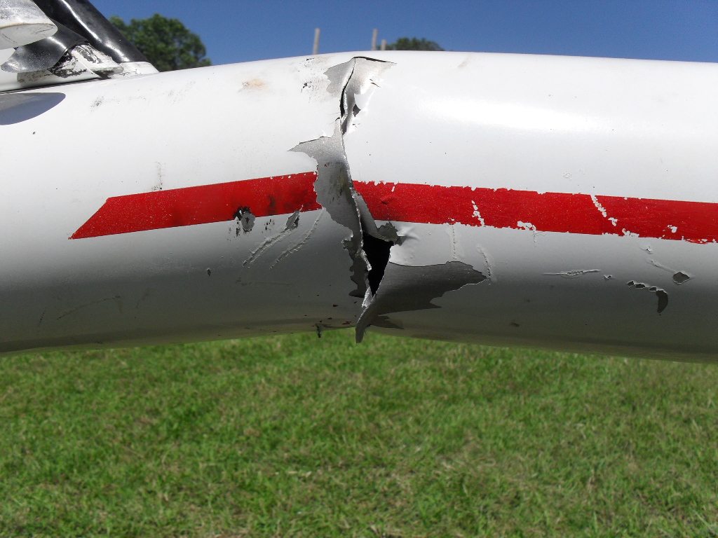

Hi, my name is Chris I recently purchased a Firestar and have been spending a fair amount of time on the list gleaning information. Well all was fine with the plane until last Friday when I hauled it on my open trailer down the freeway. I have been hauling it about 15 miles on the weekends to a small uncontrolled airport without issue. But on this longer and faster trip I managed to break the fuselage tube just behind the support stand I built. I have ordered a replacement from Kolb (Travis is a super guy to work with). I was just wondering if anyone has any tips or tricks when it comes to replacing the tube. Here are the pictures of the damage.
Chris
 Filesize:  583.45 KB
 Viewed:  22430 Time(s)
 Filesize:  589.83 KB
 Filesize:  506.81 KB
 Filesize:  508.97 KB
PostPosted: Tue Jun 22, 2010 4:00 pm    Post subject: New guy with repair questions Reply with quote

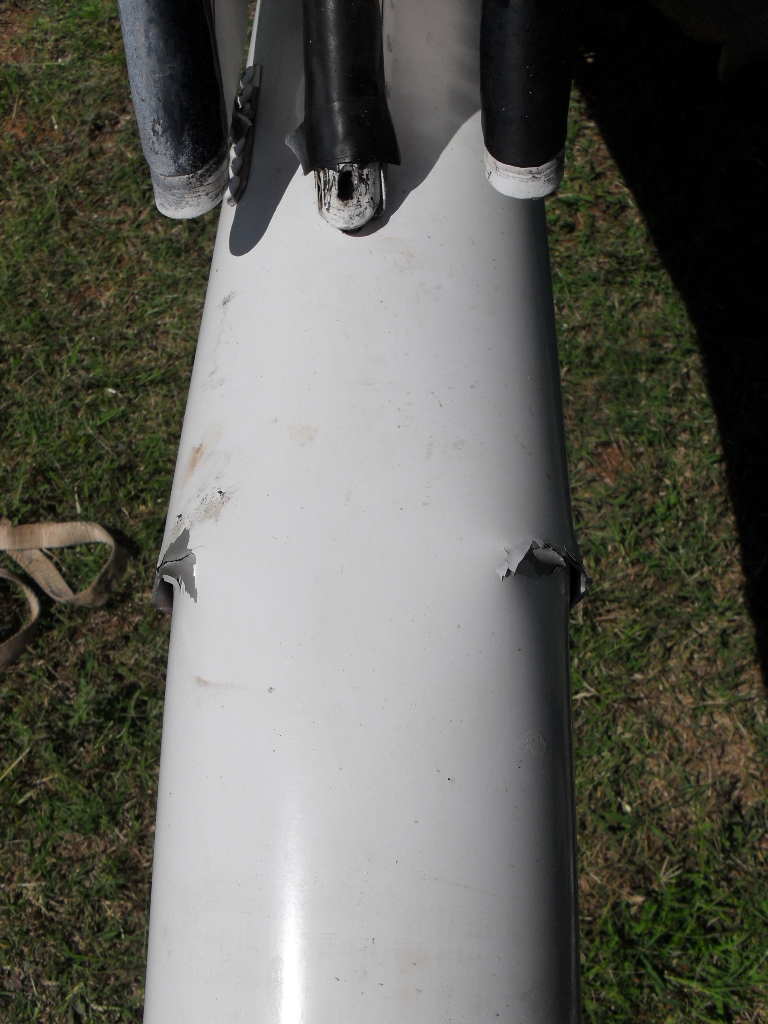

Chris
I'm guessing you never built a Kolb.
Removing the damaged tailboom is a major task.
Replacing the tailboom is a major contruction project:
-cutting to correct length.
-fitting to fuselage and installing the H brace.
-rigging and installing the tailsection.
Recommend you obtain a Contruction Manual and Plan Sheets for that project.
Good luck.
Still scratching my head how a tailboom could be destroyed like that.

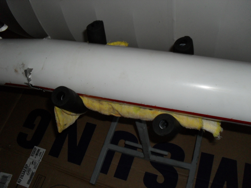

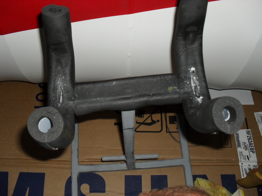

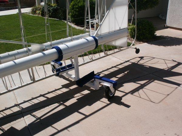

Here is my boom support. When I loaded the firestar the pipe insulation was still intact. The way I secured it was: wrap a towel around the tube then with the tube in the straddle I would wrap a ratcheting strap around the tube and straddle and tighten it up to the point that the foam would start to compress slightly. Then ratchet the base of the straddle to the floor of the trailer. The break occurred immediately after the rear straddle arm. It's pretty clear the tube was bouncing enough to chew through the towel and foam. But the straps were not loose at all.
Thanks for the input,
Chris
 Filesize:  574.84 KB
 Viewed:  22398 Time(s)
 Filesize:  585.09 KB
Thom Riddle
Posts: 1597
PostPosted: Wed Jun 23, 2010 2:45 am    Post subject: Re: New guy with repair questions Reply with quote
I don't see any problems with the boom support design so the reason for this odd break is probably one of two things.
1- The trailer is designed (sprung) for a much much heavier load than the Firestar weight which will result in the "springs" not actually springing at all. Like a hard tail Harley, no springing but the seat coils (boom tube foam).
2- The boom was stressed and strained already from repeated "hard-tail" trailering or some other incident before you acquired the Firestar.
If the trailer is at fault, you need to fix or change the trailer before hauling your Firestar again. Ideally, the trailer should be a light duty one with a load capacity of not over about 1,000-1,500 lbs. max, less is better. If your trailer is a heavy duty one, then at least reduce the trailer tire pressure to get some extra springing from them.
When I hauled my second purchased Firestar from SC to NY it was in a big heavy dual axle trailer but I reduced the tire pressure to help compensate. I also supported the tail boom as close to the ventral fin (tail wheel rod/spring) as possible to reduce the "overhung" load arm to a minimum and the boom support had about three inches of foam rubber before compression and about 2" thick compressed from the static boom weight.
Thom Riddle

Thom, Chris, Looks like the point that generated the failure is the weld where the saddle tubes attach. Even with the pipe insulation the design has a very small contact area. Then consider that the attach tube for the folded wings is 2 feet or more behind the end of the boom support. Say each wing is a 25 lb load at that point, X 2 is 50 lb., add the tail weight as another 15 lb., say, and you have 65 lb acting on a 2' or greater arm. Now multiply times 6 and you've got 790 lb cyclic load (that tha-thump from the tar strip, expansion joints or washboard (concrete or asphalt acted on by big trucks will washboard just like a dirt road)) acting on that small contact point. Once a dent is created (you can see dents in the picture bottom_180 at both the failure point and also at the forward saddle contact point) failure follows rapidly.

Rick, good point. I hadn't considered he might have supported the wings on the tail. That is only a convenience for pushing it into a hangar,not for transport. In a trailer you should either remove them and hang from straps on the walls or, if left attached, hung from the ceiling.
Put a buffer strip on the nose to take the shocks.

Thanks for input everyone,
I did trailer it with the wings attached to the boom. How do you guys with open trailers deal with the wings? The trailer is pretty light weight, I'm not sure what the rating is though.
Greg
Greg,
  I've been listening to everybody's advice opinions, etc.  All seems like pretty good info.
Rick G. analized the math behind what happened.  Thank God your boom broke on the trailer.  That concentrated stress he mentioned could have set up a weak point that may well have broken in flight!!
  Did you get the "H" frame?  You absolutely positively need a new one!  Trying to use an old one will possibly set up your plane to a potential crash.  IMO!
  When you trailer your plane, as has been said, the weight of the wings should NOT be joined onto the boom tube.

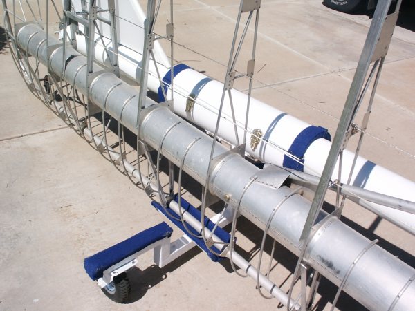

  For trailering, here is the boom support I built.  Note; each wing has it's own cushioned,
pivoting, long pocket.  The boom support itself is a 36" long piece of 8" diameter of PVC water pipe (available free from 99.9% of your local water department).  The PVC pipe was cut lengthwise, and closes firmly with some latches.  I padded it in a couple of layers of carpet foam rubber, then wrapped in some nice upholstery fabric).  My boom tube is support by 36" of tightly fitted foam (and NO wing weight).
  My design is taken from Uncle Craig (on this list), with my own modifications.  If you need more photos, let me know.
Mike Welch

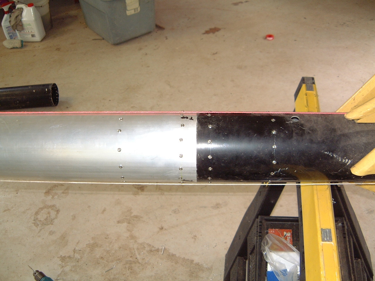

Here are
Chris

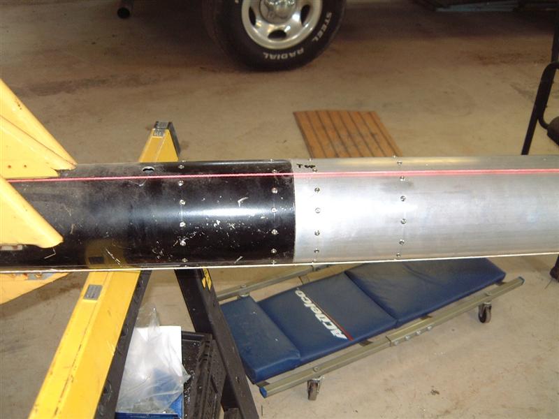

Chris,
I'm not an engineer and can't recommend what to do, but I feel the
repair I did after my fuse tube bent from an engine out and rough
landing in my Ultrastar was actually stronger than original. I
conferred with a number of knowledgeable people and was told only to
keep alert for any movement between the pieces as time went on. In
essence, all's tight, all's OK.
I got a tube and cut it the same length as the damaged section I was
replacing. Then I cut a piece about a foot long from the damaged tube
and had a kerf cut length-wise so I could slip it into the existing tail
section and the new tube. It fit nice and tight; had to tap it in with
a block of wood over end of tube. Then I riveted it as shown in the photo.
That was my fix, you may choose to do it differently, but the time saved
was significant and when it's all painted the same color not too many
people would know it was different from the kit.
Best,
Dave Kulp
Bethlehem, PA
FireFly 11DMK
 Filesize:  631.15 KB
 Viewed:  22357 Time(s)
 Filesize:  608.73 KB
 Filesize:  63.95 KB
PostPosted: Wed Jun 23, 2010 8:51 am    Post subject: New guy with repair questions Reply with quote
Best,
Dave Kulp
Dave:
Good looking job on the tailboom splice. I'm sure it will pass muster with
our resident engineers. However, I wouldn't fly it because that splice
would be nagging me in the back of my mind the entire time I was in the air.
Right or wrong, I have to be comfortable with what I am flying, or it takes
the fun out of it, and that is what flying is all about for me.
john h mkIII
