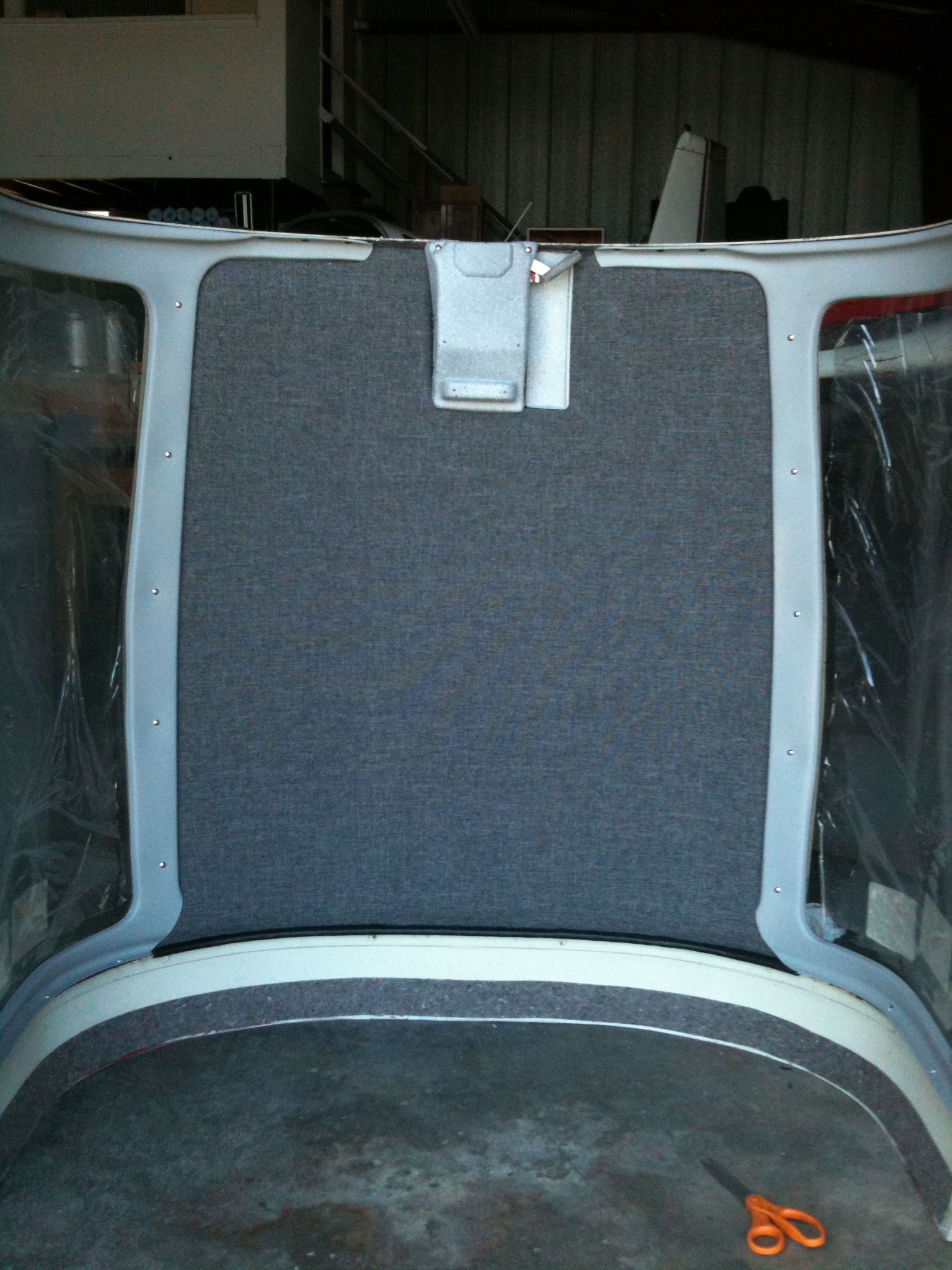

1379: Canopy headliner and windows, and window moldings by Vogt. Often imitated, never duplicated.

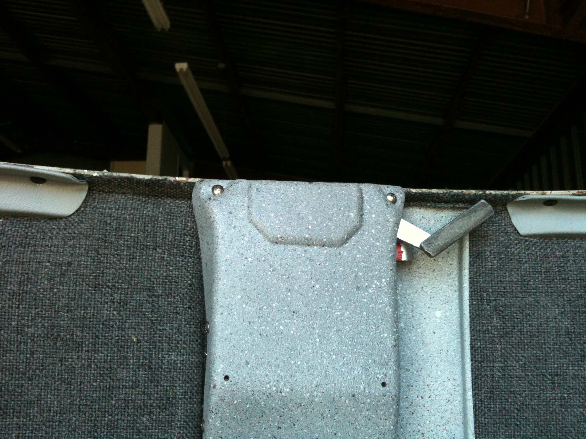

1383: Detail of canopy latch cover. With very little effort, the canopy plastic could be modified to fit to the latch cover.

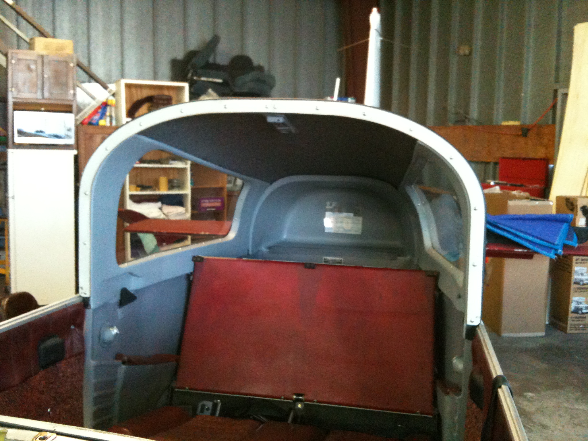

1385: Cabin ready for rear seats.

The headliner is fabric from AirTex. The plastic is from Fletcher. I eliminate the center section and I have a fiberglass fabricated cutout for the latch arm. It isn't cheap, but it looks good.
