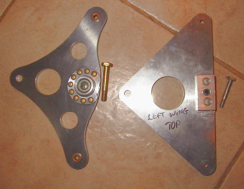

I wondered the same thing when I saw the aileron bellcrank. I made different ones using a ball bearing for the pivot bearing and bronze bushings for the cable clevis attachments. The bearing and bushings are from Aircraft Spruce. The new bellcrank is a bit lighter than the original. The thickness is the same so the original attachments can be used with the holes drilled to fit the ball bearing ID.

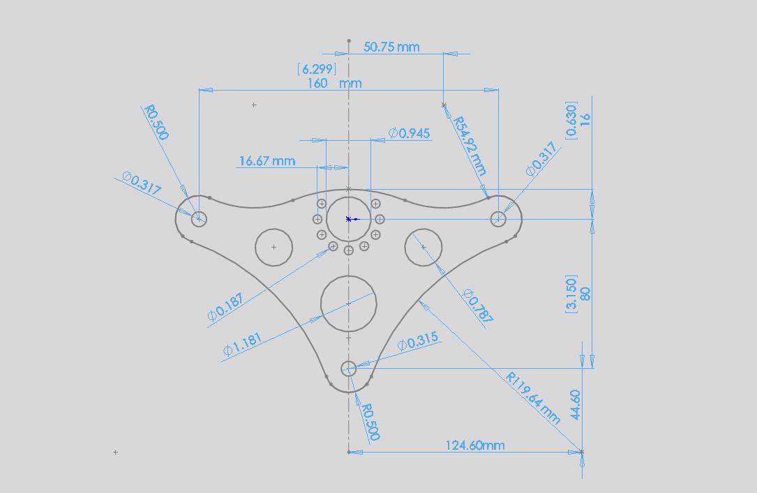

You are a true craftsman. You new bellcrank is a work of art. Do you have a
drawing of your design? It looks like a very good design improvement.

I do have a drawing I made just to see if it would work. I Printed out a full size example and cut it out from cardboard. I can't remember if any slight changes were done when I cut it from aluminum. I don't think so. The drawing was done in Solidworks. I exported a .jpg file of the drawing so the quality isn't so great. The bronze bushings are Aircraft Spruce P/N FF303-01. Look under Hardware, Bushings. They are $0.19 each. Drill the bushing hole in the bellcrank slightly undersize and press in the bushing. The bellcrank bearing is Aircraft Spruce P/N BC4W10 (AN218-4). Look under Airframe parts, Bearings. It costs $18.95. This bellcrank doesn't require any changes to the normal mount and the geometry is the same as the Zenith bellcrank. Use a washer on top and bottom of the bearing to insure the bearing housing doesn't rub on the support when you tighten the bolt.
I don't know how much drag the fairleads would add to the aileron movement. The cables don't move very far to give full travel. It'll be something I'll check when I connect the controls.
BTW, the SS rivets work great. Thanks

Have you tried exporting the drawing to a .png? I find that png's do not
have the noise that creeps into jpg's at the sharp, black-white boundaries
in drawings and text. If you could email me a copy of your image, I'd
appreciate it. Another alternative to jpg's is a pdf. The Windows freebie
pdf creator from SourceForge is invaluable to me. I'm sure that there are
Linux equivalents.
