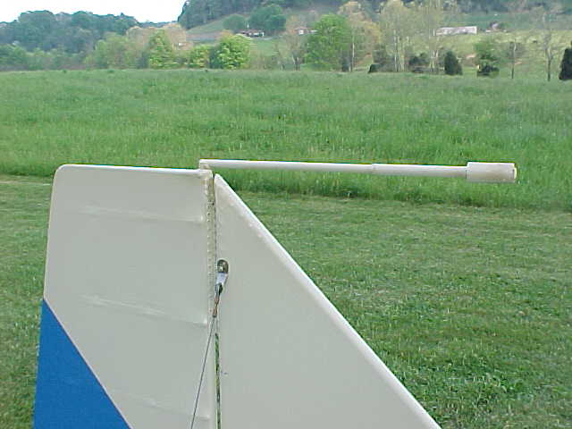

As John says, the only way to stop the rudder from fluttering is to keep your feet on the pedals - or build yourself a counterweight for the rudder similar to what Kolb sells for the ailerons.
Here's mine - takes a LOT of weight to balance that big ol' rudder. Especially if you stick the rear nav light on it - which I would put somewhere else if I had to do it over.

Hi Richard/Folks:
Nope. Keeping feet on pedals and counterbalance weight is not the only way
to cure rudder flutter.
I said I wasn't going to explain how I corrected my rudder flutter problem
because I am still typing with two fingers until the bone heals in my right
hand, and it takes me 90 forevers to knock out a short email.
Rather than use an oversize counterbalance weight, my fix is clean and
simple, and allows me to fly my mkIII with feet on the deck and off the
rudder pedals if I wish, and I do quite often on long cross country flights
when I get tired and/or uncomfortable.
I use two rudder peddle springs on each pedal. This effectively does the
same thing that additional foot pressure does to prevent rudder flutter.
Quick, cheap, and clean.
