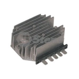

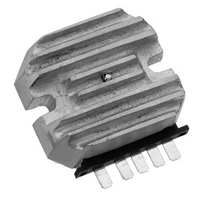

I wanted to purchase a JD AM101406 for use as a Voltage Regulator controller for a 20A. PM alternator installation. It has been touted as a “Robust” option for replacement of other regulator units.
I made a purchase over the internet and received a unit Identified only as VR-150 Made In China. It has very little cooling fin area as compared to the pictured Stens 435-159 version of the AM101406. Please see attached photos of both units.
Should the generic VR-150 be considered an adequate substitute for the robust Stens 435-159 unit?
I found that there are many internet sources for the Stens unit that are out of stock and will not be reordering, just no longer available. I don’t know what this means.

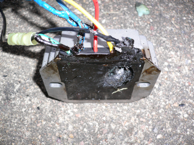

I bought an aftermarket regulator that also seemed a bit flimsy. It
couldn't handle the current. The result is attached. When it melted, the
stench was terrible.
I did find in Houston a source (a tractor parts company) for the genuine
Kubota part identical to the regulator that came with my Jabiru 2200.
Also, I installed a 1" tube coming from the Jabiru cylinder head duct
blowing directly on the regulator, and haven't had any more trouble.
