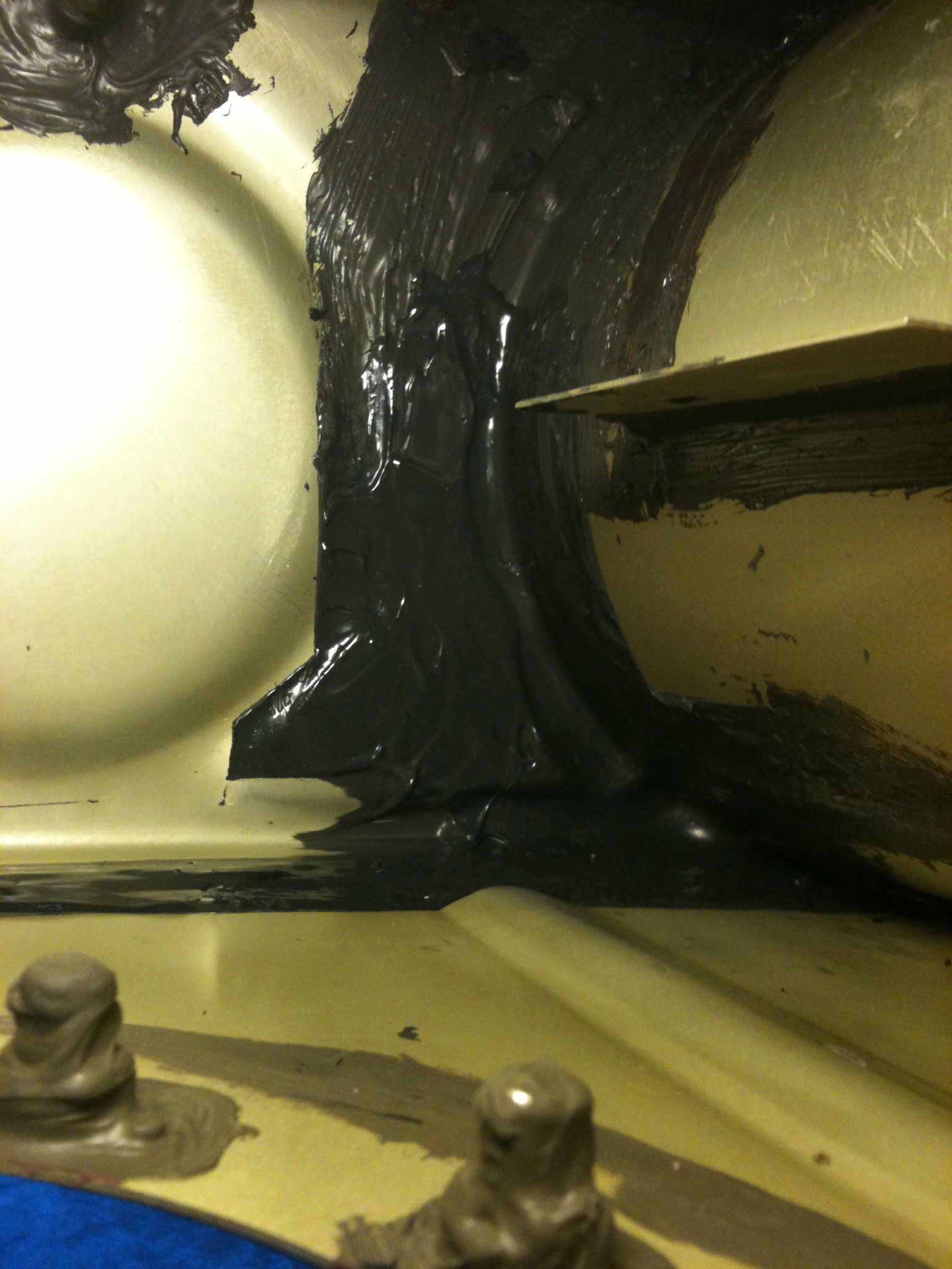

I removed the strap around the wing. Nothing. No stains at all. There was, however, fuel tank sealant applied to the outside. It looks post wing completion. I pressurized the tank again and after 30 seconds or so, went to look for leaks. Nothing. What a pain in the ass. I needed to look for leaks with the tank pressurized.
Then I thought, if I could plug the vent line, how could I pressurize the tank? Well, the solution was to pressurize through the sump fuel drain. I plugged the vent, then applied pressure at the drain, pushed it in as if to drain (but with air pressure on it) and I could hear bubbles going into the sump. Good first start. I waited about a 15 seconds, then, removed pressure. No leaks. I went to the vent line and removed the plug. A small mount of air escaped. Good. It works. So, plug back in, I pressurized the tank and waited about 30-45 seconds. Keep in mind I'm using 120 psi. I'll bet that got your attention. No, I'm using about 1 or 2 psi. Then I went looking for leaks.
Guess what. On the very bottom of the spar, at the edge of the wing skin, where the sealant was applied, a very tiny wet spot. I got a paper towel and put it on it. It was that hard to see. There it was; the little bugger. Under pressure, at the rate it was leaking, it would take forever to drain the tank. If I had to estimate the hole size, I'd say about 100 microns.

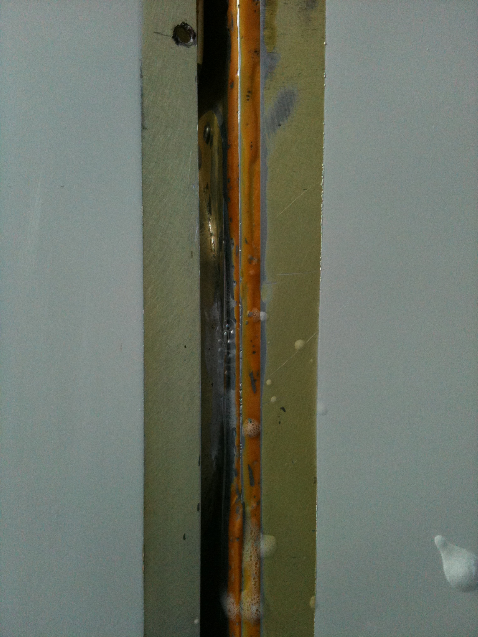

After I cleaned out all of the sealant on the OUTSIDE of the tank, I pressurized and squirted on soapy water. You can see it in pic 1359. The other side of the leak looks like this: 1258. About the only ay I can see that it would still be leaking is if it is coming in at the top and running down the inside between the rib and any doublers. What a pain.

 Filesize:  1.08 MB
 Viewed:  4485 Time(s)
 Filesize:  1.06 MB
