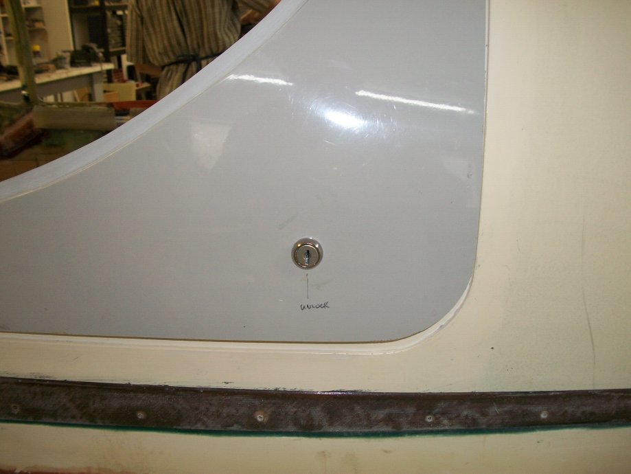

budyerly(at)msn.com
PostPosted: Thu Jun 17, 2010 8:11 am    Post subject: door locks Reply with quote
<?xml:namespace prefix="v" /><?xml:namespace prefix="o" /><![endif]--> [img]cid:003b01cb0e37$9e00bdf0(at)goldfishbk2xxe[/img][img]cid:003c01cb0e37$9e0578e0(at)goldfishbk2xxe[/img] Photo E-mail [url=http://photos.msn.com/Viewing/Album.aspx?PST=8nK2AN1B!1LEiKSdooxx9v4CFFiF2tnPWP2mfc7Vl*s7sCuc1uo!y!v8fOvAU0MuyqVUn!EUNe*JwlZhC1qo6w%24%24]Play slideshow[/url] | [url=http://photos.msn.com/viewing/Photos.aspx?pi_Type=SlideshowTask&Task=Download&stppData=&pi_ImagesOnly=1&Folder=nBuRgwTGIGjZPMtNhxCyPhYLUBR*bYP2w2HzJl4u0G0%24&User=23IQaj7Z2BRqNO1wUECSpX*P0Ju9hSGI&pi_NoLogin=1]Download images [/url]

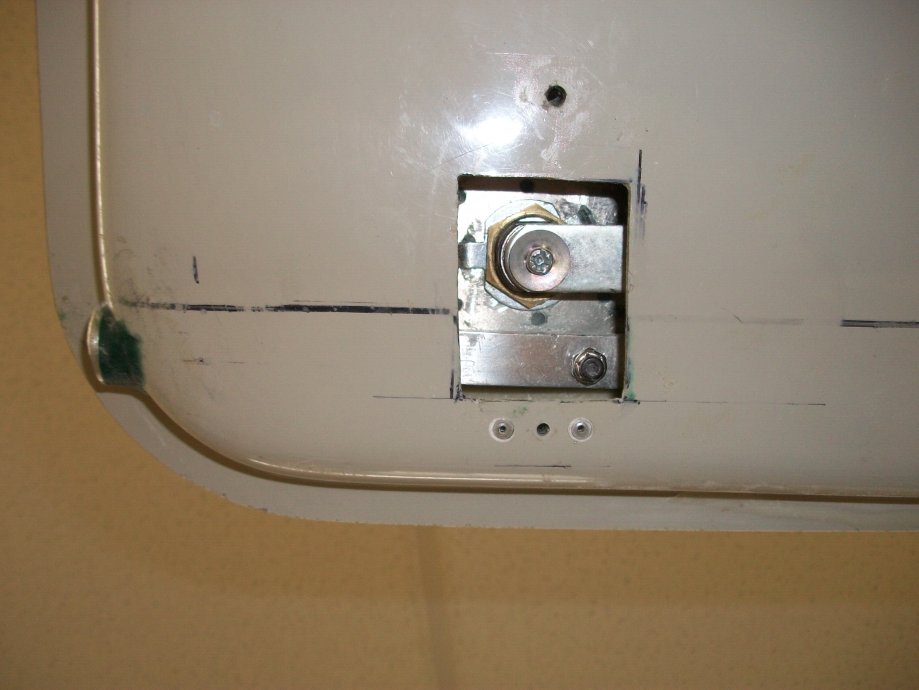

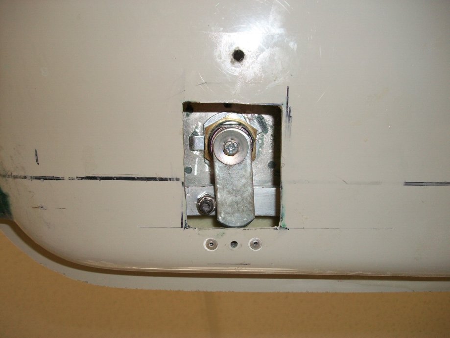

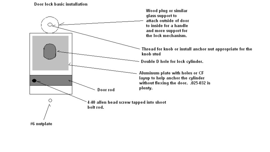

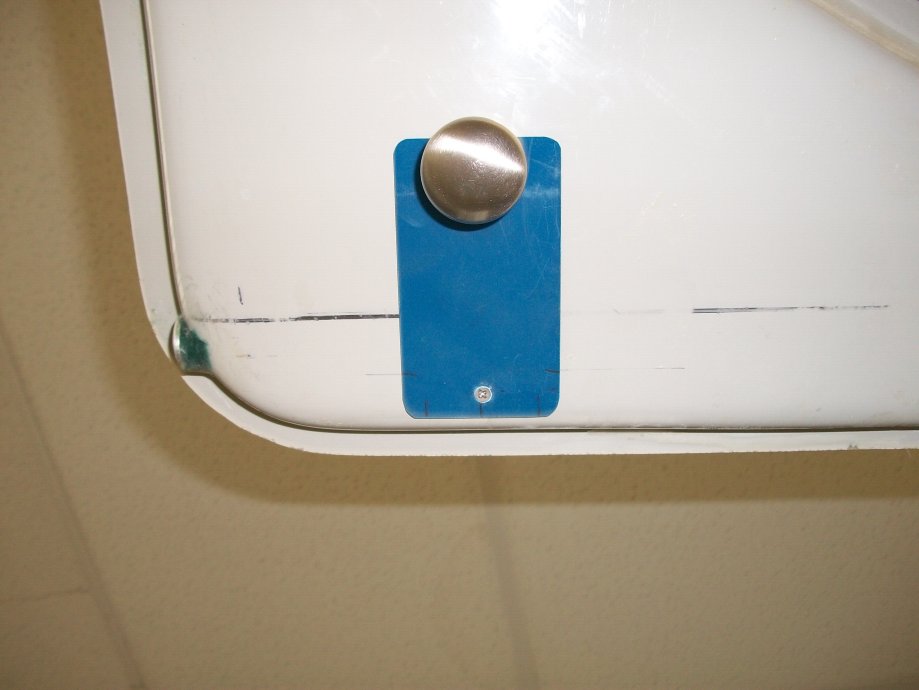

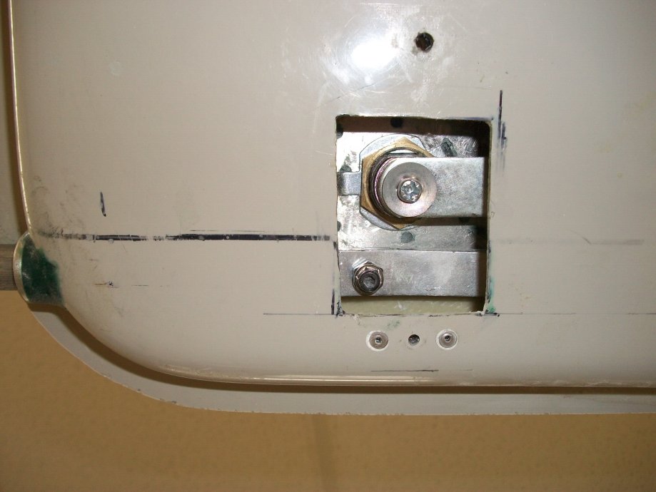

Fred,
Here is how I do it. As I'm sure you know, it is a deterrent system. You can't stop a determined thief, but it deters the less considerate person from opening up your cockpit uninvited. You won't believe what people do at air shows.. I actually prefer a cockpit cover, but that has drawbacks to.
Bud Yerly
Custom Flight Creations
[url=http://photos.msn.com/Viewing/Album.aspx?PST=8nK2AN1B!1LEiKSdooxx9v4CFFiF2tnPWP2mfc7Vl*s7sCuc1uo!y!v8fOvAU0MuyqVUn!EUNe*JwlZhC1qo6w%24%24][img]cid:003d01cb0e37$9e0578e0(at)goldfishbk2xxe[/img][/url]
Outside of door.
[url=http://photos.msn.com/Viewing/Album.aspx?PST=8nK2AN1B!1LEiKSdooxx9v4CFFiF2tnPWP2mfc7Vl*s7sCuc1uo!y!v8fOvAU0MuyqVUn!EUNe8TvZT6nZRSww%24%24][img]cid:003e01cb0e37$9e0578e0(at)goldfishbk2xxe[/img][/url]
Inside finished.
[url=http://photos.msn.com/Viewing/Album.aspx?PST=8nK2AN1B!1LEiKSdooxx9v4CFFiF2tnPWP2mfc7Vl*s7sCuc1uo!y!v8fOvAU0MuyqVUn!EUNe*PNHhz00couA%24%24][img]cid:003f01cb0e37$9e07e9e0(at)goldfishbk2xxe[/img][/url]
Door lock installed with door handle open
[url=http://photos.msn.com/Viewing/Album.aspx?PST=8nK2AN1B!1LEiKSdooxx9v4CFFiF2tnPWP2mfc7Vl*s7sCuc1uo!y!v8fOvAU0MuyqVUn!EUNe!q3QQ9W75GuA%24%24][img]cid:004001cb0e37$9e07e9e0(at)goldfishbk2xxe[/img][/url]
Handle in closed position
[url=http://photos.msn.com/Viewing/Album.aspx?PST=8nK2AN1B!1LEiKSdooxx9v4CFFiF2tnPWP2mfc7Vl*s7sCuc1uo!y!v8fOvAU0MuyqVUn!EUNe*FIy6iO13KRA%24%24][img]cid:004101cb0e37$9e07e9e0(at)goldfishbk2xxe[/img][/url]
Lock in locked position with door closed.
[url=http://photos.msn.com/Viewing/Album.aspx?PST=8nK2AN1B!1LEiKSdooxx9v4CFFiF2tnPWP2mfc7Vl*s7sCuc1uo!y!v8fOvAU0MuyqVUn!EUNe!bnX*LN78NBQ%24%24][img]cid:004201cb0e37$9e07e9e0(at)goldfishbk2xxe[/img][/url]

fklein(at)orcasonline.com
PostPosted: Thu Jun 17, 2010 9:30 am    Post subject: door locks Reply with quote
Bud...nice refinement w/ the "double D" hole and the inside knob (presumably) to ensure that rear door latch is engaged...question: Can the pilot reach both knobs?...I'm going to run out to the shop and make sure I can reach them while sitting in Ms. Europa.

PostPosted: Sat Jun 19, 2010 7:20 am    Post subject: door locks Reply with quote
<?xml:namespace prefix="v" /><?xml:namespace prefix="o" /><![endif]--> Fred,
I can and I am 5-10, so I believe most can. I always push on the backs and front of each door before takeoff as a door loss deterrent.
