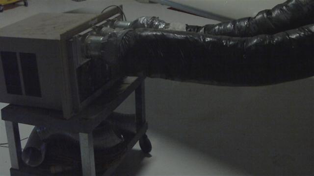

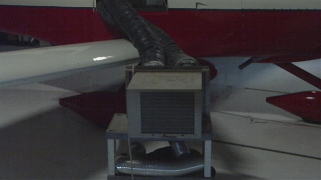

105 here today but working on the plane was not too uncomfortable due to an old window A/C unit I modified so that I could attach some house A/C ducts to. I replace the long ducts with some flexible AL ducts so that I can blow cool air at me while working on the engine.

I have done the same thing with a window unit for these hot, humid, Florida days.

My understanding of this unit is that it's a cold fan- it needs to be blown
at someone versus cooling the area. I am interested in more feedback on what
"Ok" is. Does it actually bring the AZ heat down in the cabin? how much?
The biggest issue I have seen is fitting the coolers into the baggage area-
they are all too big, The other option is having to lug it in through the
doors and into the back, also they tend to have condensation and make the
area they sit on slightly wet.
