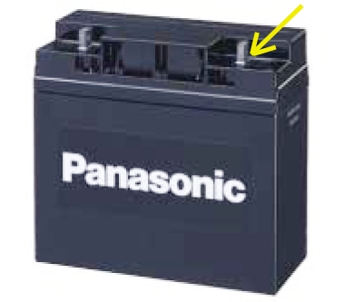

Some of the earliest experiences with SVLA battery failure
manifested as a fracturing of the lead terminal-posts
just at the top of the case seal . . .
[img]cid:.0[/img]
Root cause turned out to be 2AWG Tefzel battery jumpers
transmitting considerable stress to the posts under vibration.
Converting to welding cable jumpers fixed the problem.
However, this doesn't negate the need for support immediately
adjacent to crimped or soldered joints where the
wire transitions from very flexible to very inflexible.
