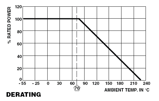

For example:
[img]cid:.0[/img]
Here'a de-rating curve for a typical metal film power resistor.
Note that it's good for 100% of power rating at 70C ambient.
When ambient rises to about 225 degrees C (that's
really toasty), you cannot call upon the device to handle
ANY power. I.e., At full power in a 70C environment, one
can expect the surface temperature to be over 200C.
The specifications for your resistor of choice should
be available on the 'net . . . but it's unlikely that
you've got a problem with respect to the resistor itself.
