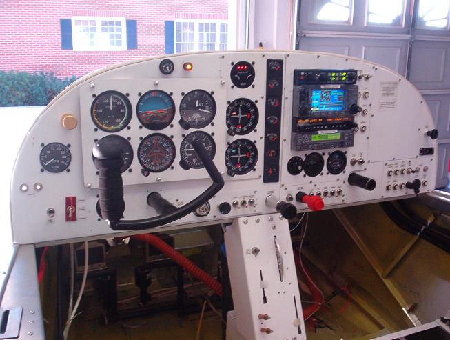

PostPosted: Fri Apr 30, 2010 4:53 am    Post subject: Re: Inspection/ Maintenance panels Reply with quote
It is great that you are thinking ahead about this. While building you have open access to everything and it is very easy to forget about doing maintenance on the completed plane, which is completely different than building. Something as simple as checking the torque on a bolt can turn into an hour long game requiring 3 hands, a mirror, the skills of a contortionist and a lot of luck, so the more access you have the better. I have the standard sized access panels in the wing, and while I have changed out a fuel sender and replaced some pitot tubing through these panels, it was tight. While people seem to like the round access holes, I think the square or rectangular holes are better. For essentially the same sized hole in the structure, the extra room the corners give seems to make a big difference, especially in giving you a line of site to see what your doing. I also put an access panel on the rear seat bottom for direct access to the control cable pulleys under the seat. Another thing to consider is access behind the instrument panel and where you put everything. Try laying on your back with your head under the panel and see how well you can see and reach things, and how long you can stand laying like that (it's not a lot of fun). So it's best to have good, relatively easy access from the front of the panel. As far as the fuel tanks, there is no sealant or bladder to go bad, so most likely any leak you have will be either around the sender or where the fuel line attaches. Making big changes to have easy access to the whole tank seems a bit overkill to me. Good luck and keep thinking ahead.

steveadams
Posts: 191
PostPosted: Mon May 03, 2010 5:30 am    Post subject: Re: Inspection/ Maintenance panels Reply with quote
My panel is just like the prototype, which with a few tweeks is actually a good design. A hinged panel would be pretty nice if the longer instruments don't get hung up on the glare shield when you try and fold it out. On the right is an open panel which gives pretty good access. I mounter the encoder, panel dimmer, and signal splitter for the VOR/glidesplope behind it for easy access, and I can reach a lot of the radio stack through this access as well. The panel is also modular, so I can pull the flight intstrument panel, VOR panel, and or radio panels out separately. It does become a challenge to keep all the wiring and tubing neat and secured, while still allowing enough slack to slide the panels out.
