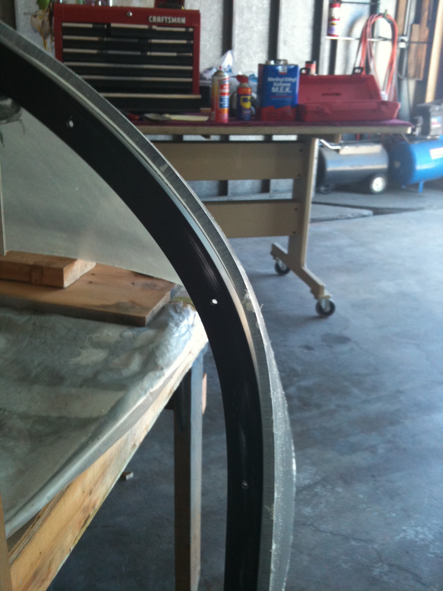

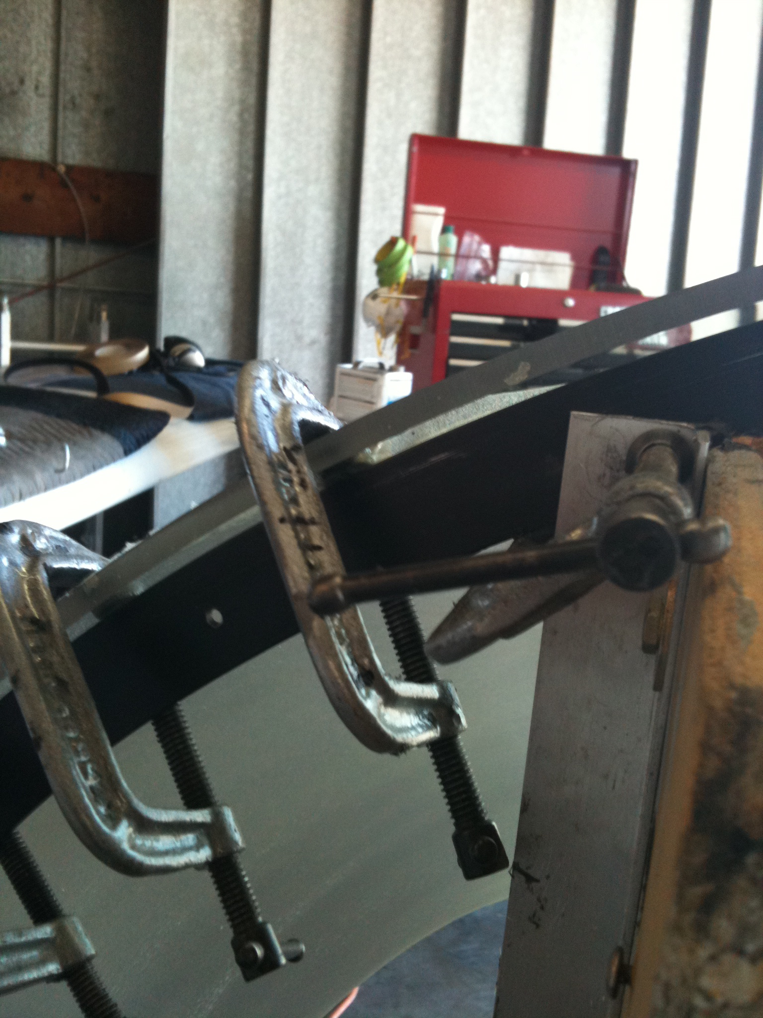

I put it on the frame today for a trial fit.
For the best bond (using RTV 732) I need a bond of around .015 inches. On a C. Bailey, I can get it to around .010 at the tightest edge on the trailing edge of the windshield bow and still have it within .025 at the leading edge at the tightest spots.
Just sitting on the bow, the LP Aero windshield has a gap greater than .125 in the two upper corners. It sits flat across the middle. No mater how I do it, it's going to look like shit.

There is no place to do the same on the LP Aero. So. . . . . I'm trying something new to keep my spacing. We'll see. Keep your fingers crossed.
Someone needs to make new tooling that actually fits the windshield bow curve. That would be nice.

teamgrumman(at)YAHOO.COM
PostPosted: Mon Jun 14, 2010 7:41 pm    Post subject: Installing a windshield. Reply with quote
The flat blade I use on the Xacto knife never even scratches the aluminum. All it does is slice off the majority of the RTV. DX330 and a 3M scrubbie removes the rest. Quite easily too.
DX330 is a very high grade Naptha. It's used to clean surfaces prior to painting. I also use it in the fuel tanks prior to resealing. It's quite expensive. I doubt the average mechanic would be inclined to use it for that reason. It removes all traces of wax and grease and it doesn't touch the plexiglass. Unlike MEK or acetone, it leaves no residue and is not going to eat up gloves or the windshield.
Years ago, I put a bead of RTV around the base of a windshield on a plane I knew leaked. I did a quick and dirty job because it was going to rain and I had no place to put the plane. Some 3 months later I scraped off the majority of the RTV and then went to work on the windshield with DX330. It gets under the RTV and releases it. It took about 30 minutes and it was all clean.
Funny how difficult it is to describe how fucked up this windshield is. I'll try to simplify it.
(1) OK boys and girls, let's pretend we are sitting in the airplane, in the pilot's seat, with the canopy open.
(2) Pretend to run your hand along the side of the cockpit, on the top of the canopy/fuselage opening, where the window track is.
(3) Pretend to slide your hand to the windshield. Stop.
(4) You are now at the windshield. The windshield is attached to the windshield bow.
(5) Let's further pretend there is no double bead windshield bow seal on the on the face of the windshield bow.
(6) At this point, you can touch, go ahead, pretend to touch the flat face of the windshield bow that is facing you, it's OK.
(7) This surface, the windshield bow, has another surface attached to it that is 90 degrees to the face you're touching. You won't be able to touch it because the windshield is in the way.
(Cool You can, however, lean over and look through the windshield and you will most likely see cured RTV holding the windshield to the windshield bow.
(9) This windshield "bow" goes up from this corner and makes an arc as it curves up and over toward the center of the windshield bow. (We'll only do one side, the right side is the same.
(10) Just for the sake of argument, let's call the halfway point, the middle of the arc, the UPPER CORNER.
(11) Now, run your fingers along the face of the bow so you get an idea that this is a FLAT surface.
(12) Remember boys and girls, you won't be able to touch the surface of the windshield bow that is "under" the windshield.
(13) Now, stand up and look out over the windshield. Notice how it is formed such that it goes forward and DOWN to the fuselage (Boot cowl)
(14) Look along the edge of the windshield where the windshield is attached to windshield bow. You can look through the windshield and see where it's bonded to the windshield bow.
(15) OK, here is where it gets tricky. Remember the face of the windshield bow you ran your fingers along in step 11? Let's go back to that.
(16) The surface of the windshield bow under the windshield doesn't stay perpendicular, 90 degrees, to the face of the bow as in step 7. It's close though. Let's leave it at that.
(17) So, that means, that for at least an inch or so along the open side of the windshield, that windshield needs to be 90 degrees to the face of the windshield bow also.
(1Cool OK boys and girls, are we all on the same page? I hope so.
(19) The windshield I got from LP Aero only maintains 90 degrees to the face of the bow at the SIDES and at the TOP, which is also the middle of the windshield bow.
NOTE: this is not to be confused with the middle of the arc between the side and the top.
(20) The worst portion of this LP Aero windshield is "IN THE UPPER CORNER" or middle of the arc. In this area, the windshield has absolutely no flat portion. It just falls away.
(21) In the ideal world, the windshield and the windshield bow have the same shape and the bonding surface is uniform and provides a uniform thickness for the bond.

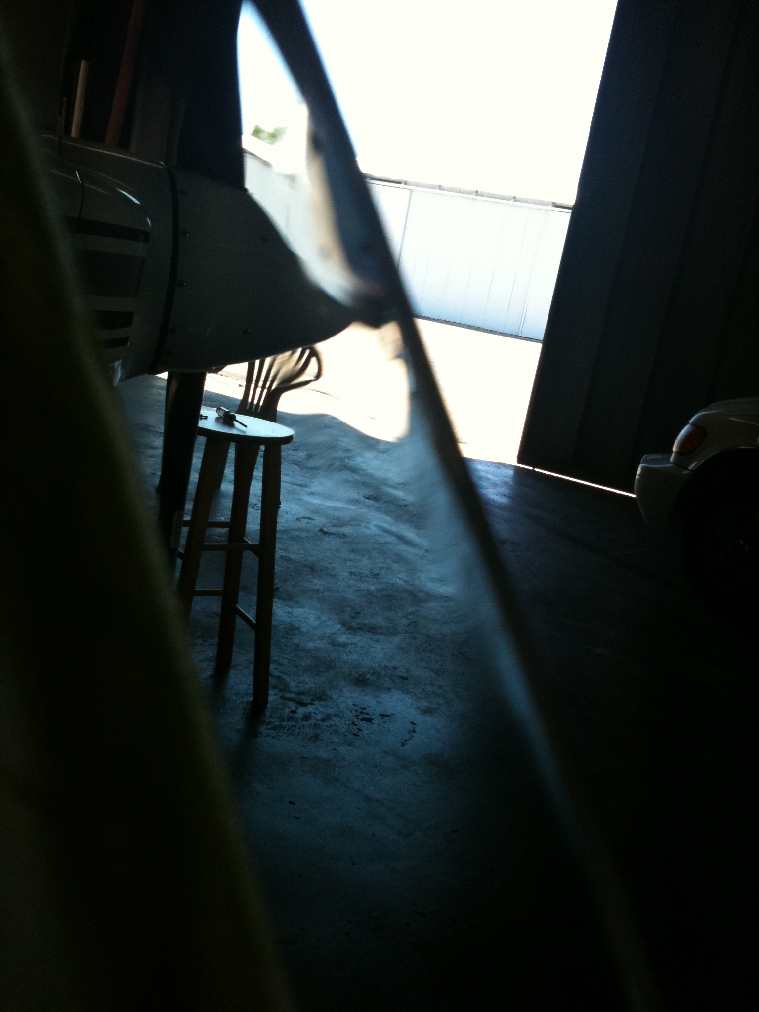

1316: This is the gap on the right side. The bottom of the windshield is tight against the bow. I.e., no gap. The gap you see a result of the windshield being misformed. The windshield is TIGHT against the forward edge. No amount of clamping is going to fix this. Short of heating and reforming, there is just going to be .130 inches of gap at the UPPER CORNER.
1317: This is the left side with clamps. The gap at the forward edge of the bow is .010 inches. The gap at the face of the bow is .140 inches.
1324: This is a shot through the edge of the windshield. It will hidden by bonding BUT, it's still a pretty bad distortion.
