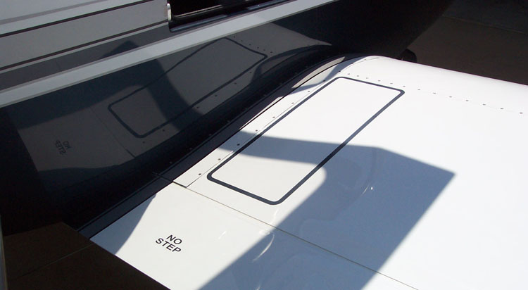

PostPosted: Tue Jun 08, 2010 3:25 pm    Post subject: Wing Walk Material Reply with quote
Mike,
The clear stuff we used works great. We added an outline to define the step area but many passengers don’t seem to be able to color within the lines. Also of note dirty wet shoes do show on the clear wing walk. It is easy to wipe off but if it were black you eliminate one more thing to spiff up. If I were to do it again I would have painted the skid the same color as my outline (steel blue-ish).
Robin
