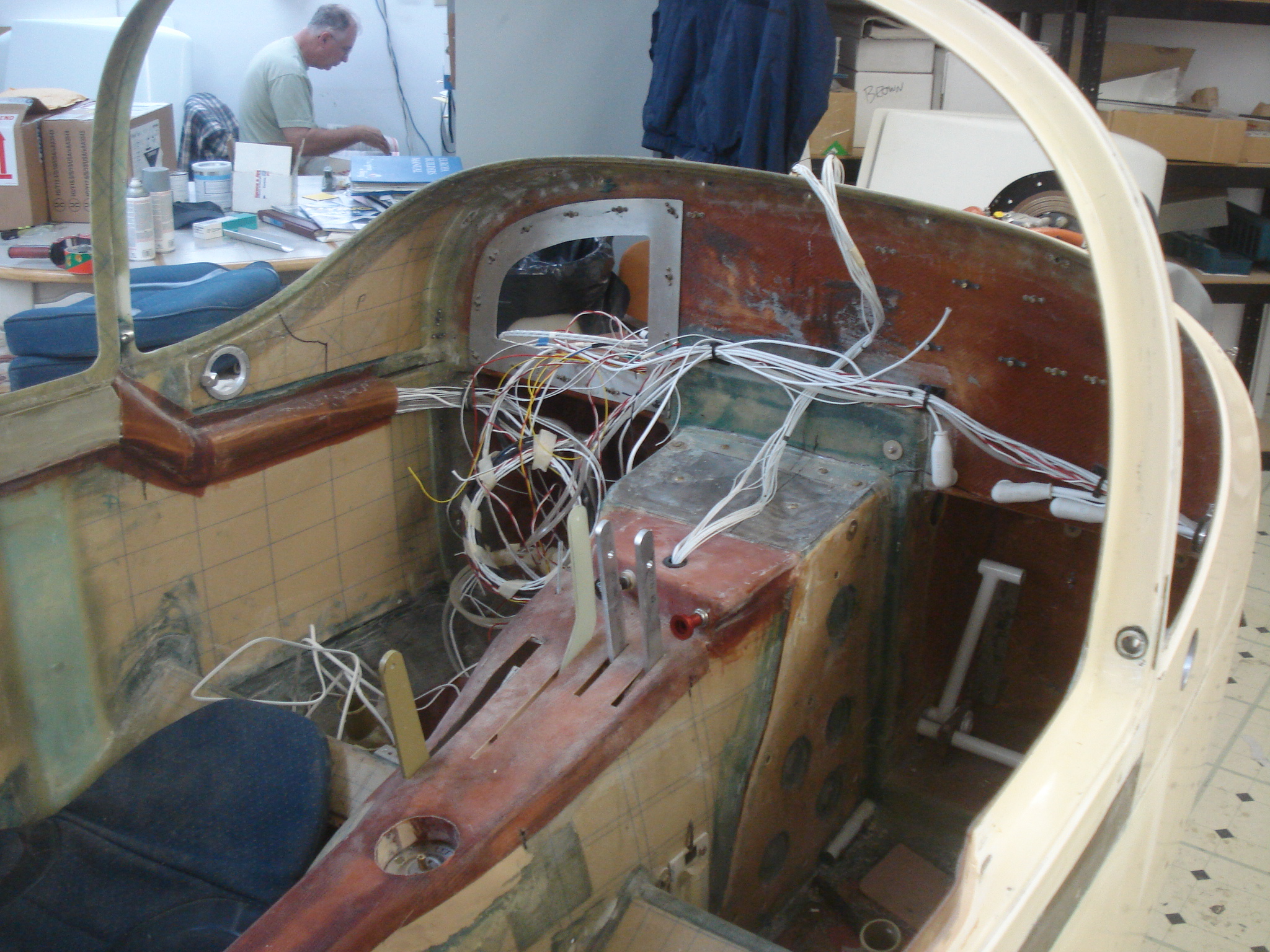

I was originally going with the (heavier) Subaru engine and was worried about sufficient strength with a heavier engine. So I used thin plywood glassed and bolted on both sides to make the firewall (angled at about 30 degrees) and tied this to a piece of plywood that runs back to the rear of the cockpit module. I glued this to the side, and and glassed it to the firewall so it makes a tee with the firewall. Then I used thin angle aluminum to tie this to thin plywood 9also glassed and reinforced with thin aluminum sheet on the cockpit sides of the center tunnel. The bolts for the frame that holds the bungies (I actually used springs) goes through the plywood, the thin aluminum and the cockpit module.
I weighed all this before I put it in and it probably added 8 - 10 pounds or so. I haven't weighed the plane yet. I rationalize this added weight in part by noting that the center board also serves as a mount for everything in the center console which is necessary as I have the finger brakes, auto pilot, all the various brake hoses, gas hoses, throttle, etc. All those mounts would weigh something.
Don't know if this was worth the effort but it sure is strong. I did learn that putting the foam between glass (or thin plywood and glass) increases the strength by several magnitudes - but you need to figure in the force vectors to get the proper strength.
The cockpit picture shows the plywood on the outside that is bolted to the bungie and front wheel frame and also bolted and fiberglassed to the tee shaped piece inside the tunnel that runs back to the rear of the tunnel. On the cockpit picture you can see Bud Yerly in the background, probably silently (or not so silently) cursing builders who add their little "improvements" that cause interference problems later on -
Gary Leinberger
