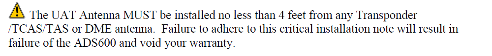

pilotdds(at)aol.com
PostPosted: Sun Jun 06, 2010 10:48 am    Post subject: Comm Antennas Reply with quote
does the transponder antenna need to be considered and what about ads-b transceiver antenna? nav and gps are receive only but do they need to be considered?I am not a fan of the archer ant for an ifr ship,in my experince they are quirky(I think thats a word).
rleffler
Joined: 05 Nov 2006
Posts: 680
PostPosted: Sun Jun 06, 2010 12:23 pm    Post subject: Comm Antennas Reply with quote
Short answer, Yes……
GPS needs to be on top.     Cat whiskers can go on the top of the vertical or on the bottom of the tail, since you aren’t using the archer  (I’m not a fan either).  While Commant states that they should point forward, there are many RVs with them pointing aft underneath the empennage.    I would also suggest reading the install manual for your ads-b equipment.   NavWork is pretty up front, for an example, here’s an excerpt:
I haven’t put in either of these yet, but I’m thinking the transponder will go in the tunnel near the firewall and the ADS-B will be back by the battery someplace.
bob
From: owner-rv10-list-server(at)matronics.com [mailto:owner-rv10-list-server(at)matronics.com] On Behalf Of pilotdds(at)aol.com
Sent: Sunday, June 06, 2010 2:47 PM
Subject: Re: Comm Antennas
 Filesize:  22.75 KB
