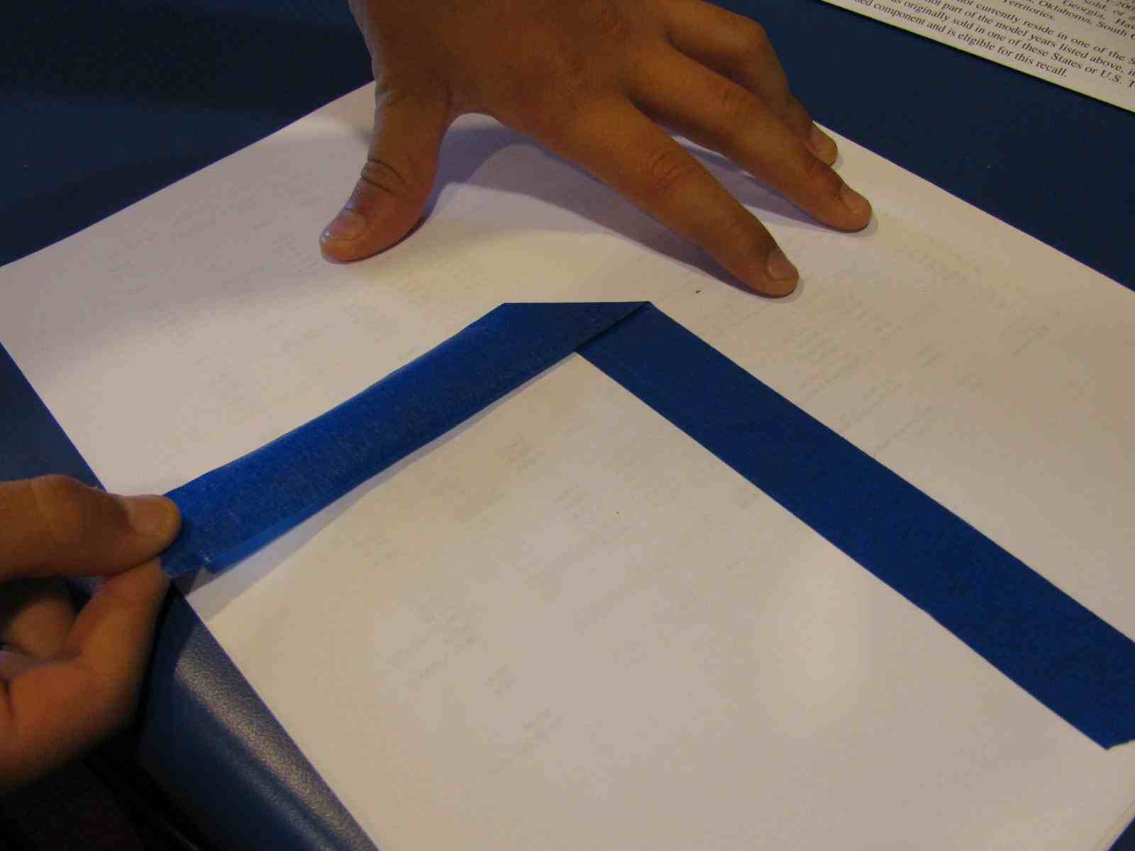

Thanks Dave for the tips, the issue I've had so far was bringing the resin to electrical tape which looked fine as I laid it in. The problem began as I began to remove the tape, the overflow of resin on the tape in some places began to pull up on the areas of feathering to the point that it looked as if it did not have good adhesion to the plexiglass. I did sand the plex very well but as I pulled the tape I could see the area turn a whitish color indicating a pulling away. My concern is the adhesion down the road and the pulling away/bubbling of the paint. If I hear you right the last 1/16 inch of polyfiber should feather nicely and resolve the concerns of any pulling of resin from the plex?
Dave Ford
Cadillac, MI
dave.saylor.aircrafters(a
PostPosted: Sat May 29, 2010 7:46 am    Post subject: windows & fiberglass Reply with quote
Dave,
If the resin is peeling up with the tape, there could be a few different things going on.
Keep in mind that the chemical bond between typical laminating resin and plex is never great.  You get a decent mechanical bond by scuffing the plex, as you did.  Not to digress, but Weld-On, for example, does a better job bonding chemically to the plex than laminating resin ever does.
By reinforcing the resin with the fiberglass layers, you can sort of cantilever a little bridge out over the plex.  The glass helps the bridge be stiff enough to ensure that the relatively weak bond to the plex is protected, that the bond to the plex doesn't see a peeling load, and it stays stuck.
What may be happening in your case is that the body of resin between the edge of the glass  and the tape is too wide.  Then the un-reinforced resin could be flexible enough that removing the tape breaks the weak resin bond.  If that's the case, then you'll need the glass to be closer to the edge of the tape.
Or, you may have some resin still overlapping the tape so when the tape was lifted it pulled on the resin too.  You'll need to sand all the way down to the tape to make sure that the only part of the resin touching the tape is the tiny vertical "thickness".  By all means make sure that the glass doesn't overlap the tape.
One thing you might want to change is the way that you remove the tape.  Once you get an inch or so of the tape lifted off the plex, try folding the tail of the tape back around so the sticky side is up, and pull the tail back at 90* to the masked edge--see attached photo.  That puts the least amount of peeling stress on the resin/plex bond.
Another problem might be that the resin is still a little soft.  There's a period before it's fully cured when it's still kind of rubbery and it might pull off the plex.  You have to be super careful if you decide to try to warm the resin around plex--the plex starts to deform at relatively low temps (see:  my windshield-grr).  We use electric blankets almost exclusively now whenever we want to hurry up a curing cycle.
Let me know if you think you have something different going on.  We'll get it figured out.

I think this is probably what is happening, a combination of not enough glass close to the tape, too wide of a resin bridge, and resin left on the tape. So I'll redo & leave a smaller gap, use polyfiber to feather in to the tape, then sand the electrical tape to remove any film that may pull. I'm assuming two layers of glass would be sufficient.
