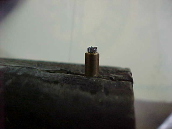

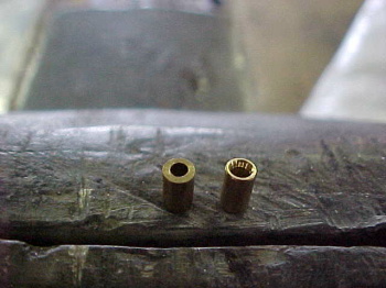

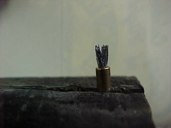

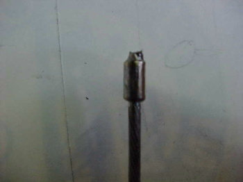

I make all my own cables. Here is a way to positively prevent the cable
ends coming off.
The attachments show typical CPS cable ends, and then show it slid over
a cable.
Note that they have a beveled and an unbeveled end.
The beveled end is to make it easier to slip it over the cable, but you
don't care about that, you are going to use the bevel for the opposite
reason - to make it impossible to get the cable to come out of the
swedge end, so you slip it on the cable backwards.
You want the swedge with the beveled end towards the end of the cable.
Slide the swedge over the cable
Rat tail the end of the cable. Screw it up good. You want a cable that
is too buggered up to fit back out through the swedge anymore.
The goal is to make it impossible to pull back out.
Now pull it down into the swedge until it you have 1/16" to 3/32"
sticking out.
Lay some solder on it, do it right, let it cool.
You especially want the solder to fill all the rat tailed ends of the
cable, and be well attached.
Now you have a cable that is expanded just past the bevel, it is too big
to go through any more, plus the solder filling the end makes it too big
to go through, plus the adhesion of the solder to the swedge.
Test it. Pull it through if you can. If your solder job is any good at
all, you can't.
ends coming off.
a cable.
sticking out.
all, you can't.
