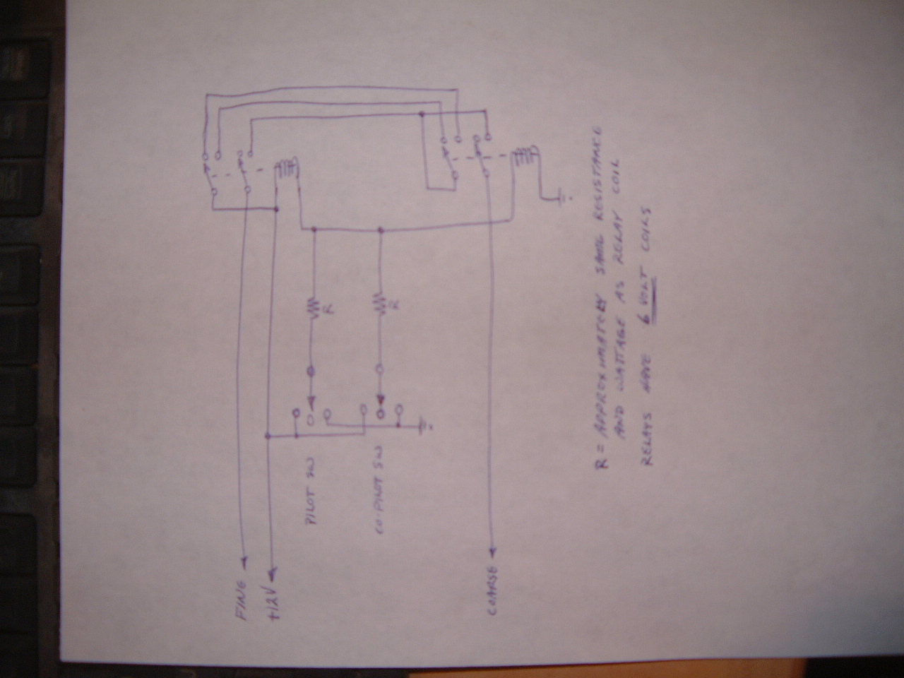

PostPosted: Sat May 29, 2010 6:36 am    Post subject: Tri State Logic help needed Reply with quote
Ron;
Attached is a circuit which is not particularly elegant will function as you've requested. I'm not certain that the possible failure modes are acceptable, or that you'd be happy with the relays constantly energized which is the way this circuit operates, but for what it's worth here it is. Sketch is shown with power disconnected, relays in relaxed (off) position. This circuit will connect the fine and coarse wires to each other during normal flight operation. If this is not acceptable then a diode could be introduced in each of these wires to isolate them from each other.
<![if !supportLists]>· <![endif]>With the stick switch in centre – no connection – (Situation 1) both relays are energized and no power can flow to either coarse or fine output wire.
<![if !supportLists]>· <![endif]>With stick switch supplying +12V – (Situation 2) - Upper relay has +12 on both ends of coil, therefore turns off and lower relay supplies +12V to “coarse” wire.
<![if !supportLists]>· <![endif]>With stick switch supplying ground – (situation 3) - Lower relay has both sides of coil grounded therefore turns off and upper relay supplies +12V to “fine” wire.
Resistors should be approximately the same resistance and wattage as the relay coils. You require a resistor in the lead from each stick switch so that in a situation where one stick is selecting coarse and the other fine, the resistors dissipate the energy which would otherwise be a dead short through the grip switches. In this scenario, theoretically the relay common point would remain at 6 Volts and no pitch change would happen. You could also incorporate a panel switch into this circuit, wired the same way. Note also the relays have 6 Volt coils.
Bob McC
