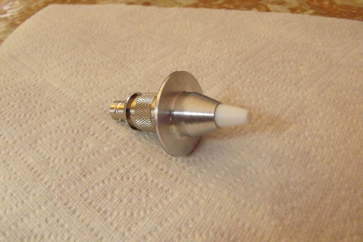

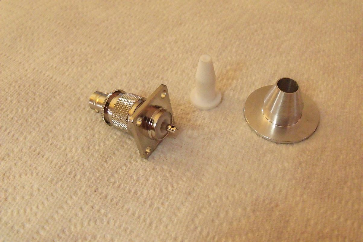

Great minds think alike? :-} This project rose back to the top of the pile again now that I have a working PTT for the little Vertex radio. Next step solder, add ground plane and some radials, and mount on the plane.
Rick Girard
On Mon, May 3, 2010 at 7:25 AM, Robert L. Nuckolls, III <nuckolls.bob(at)aeroelectric.com (nuckolls.bob(at)aeroelectric.com)> wrote:
--> AeroElectric-List message posted by: "Robert L. Nuckolls, III" <nuckolls.bob(at)aeroelectric.com (nuckolls.bob(at)aeroelectric.com)>
At 01:37 PM 5/2/2010, you wrote:
Bob, I'm going to solder a piece of 3/32" brazing rod into the center lug of the PL 259 chassis mount (the lug is drilled out to let it slip in for a good mechanical attachment once the soldering is done), trim to appropriate length and use it as an antenna for my hand held.
 Okay, figure out a way to substantially beef up support
 of the rod right and for about 1" away from the solder
 joint.  If allowed to "wave in be breeze" it's going
 break at the solder joint and depart the airplane . . .
 if I recall your airplane configuration correctly,
 there may be risk of putting that piece of wire through the prop?
 A piece of Delrin, polycarbonate, etc cut drilled and
 mounted to supply support is recommended.
