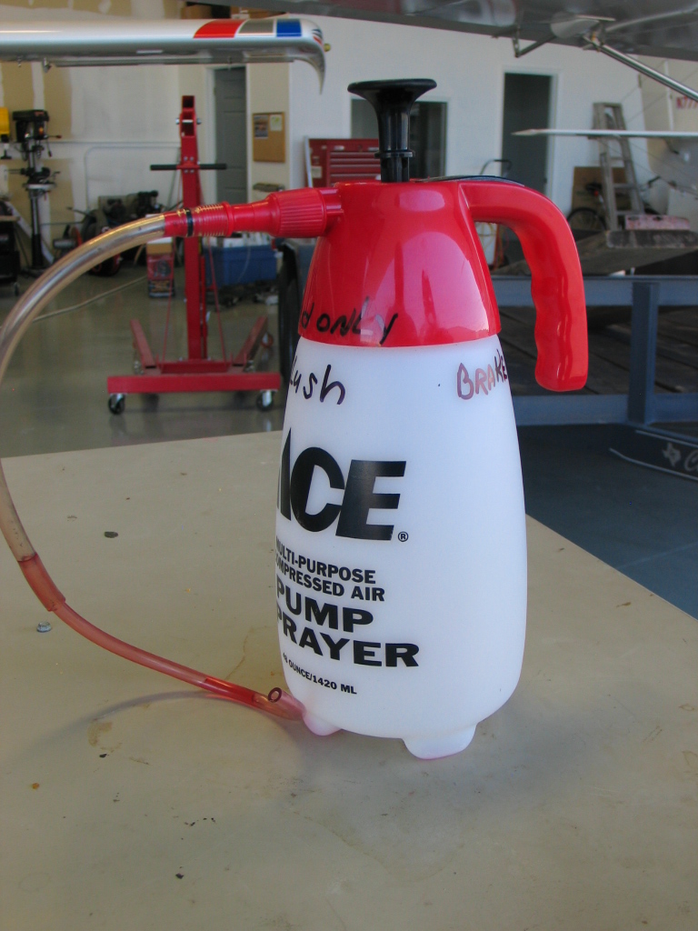

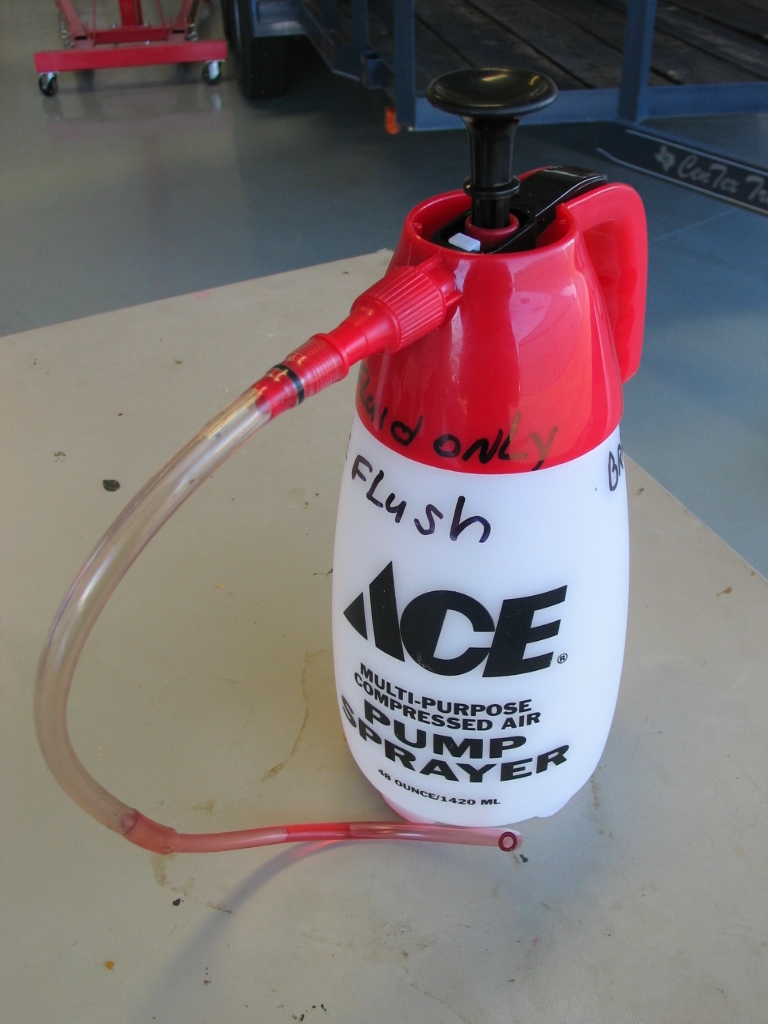

here is what I use for a brake bleeder. works like a charm. and it is only about $10. I picked it up at Ace Hardware. One of the best things I ever bought. It makes bleeding brakes very easy and fast. It blows out all the air bubbles.
Brake Bleeder
 Filesize:  295.48 KB
 Viewed:  15284 Time(s)
Brake Bleeder
 Filesize:  285.91 KB

I am having a heck of a time bleeding all the air out of my duel MATCO brakes. Can you explain your procedure using the ACE pump.
Can I get your phone/email so I can chat more.
