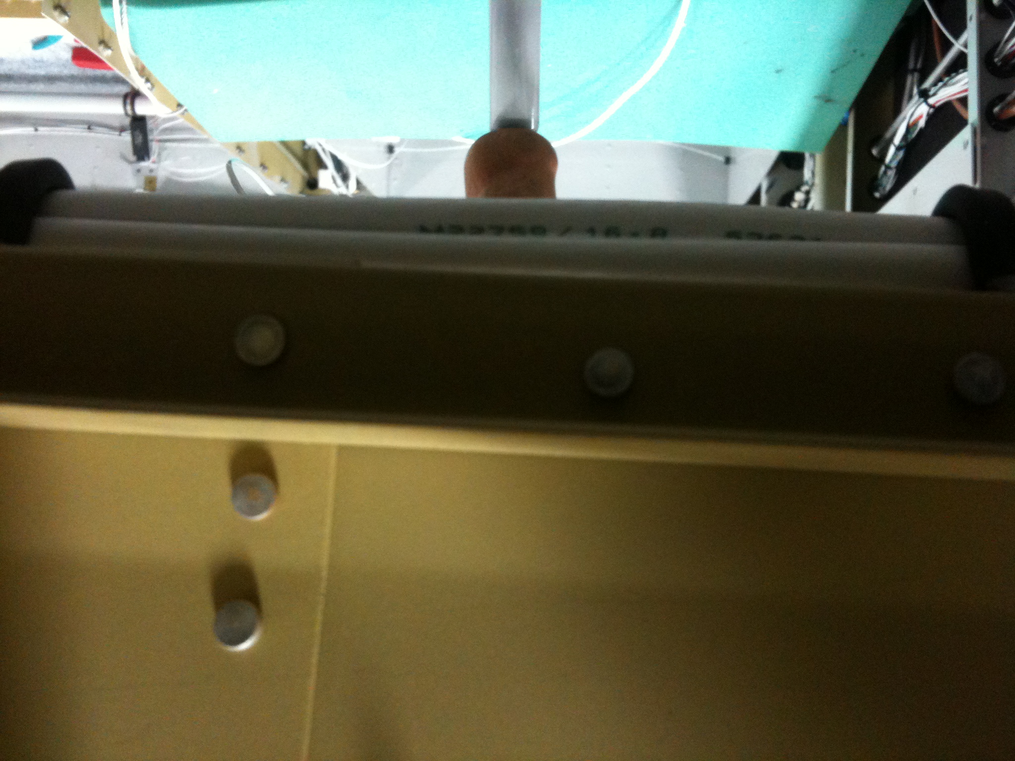

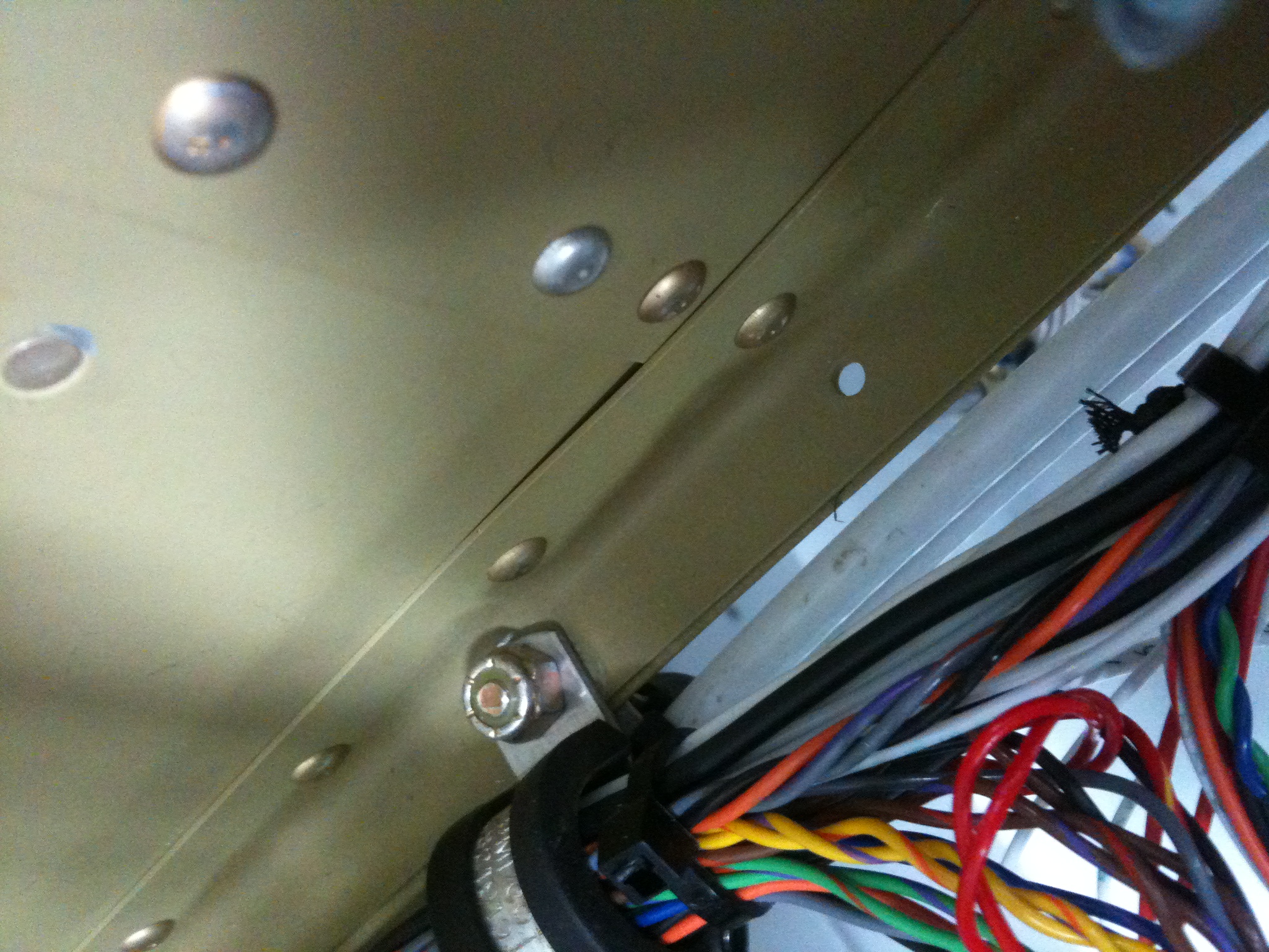

I put on a .020 doubler angle on the front, and an .063 extruded AL
piece on the back all the way across the width of the sub panel. The
front angle ties to the vertical bulkheads, the rear butts next to them.
No real engineering analysis done, but it worked in my buddies -10 for
300+ hours and I'm doing the same. This really stiffens up this area.
YMMV
-Mike
This view is aft of the sub panel looking foreward and down
This view is fore of the sub panel looking back.
